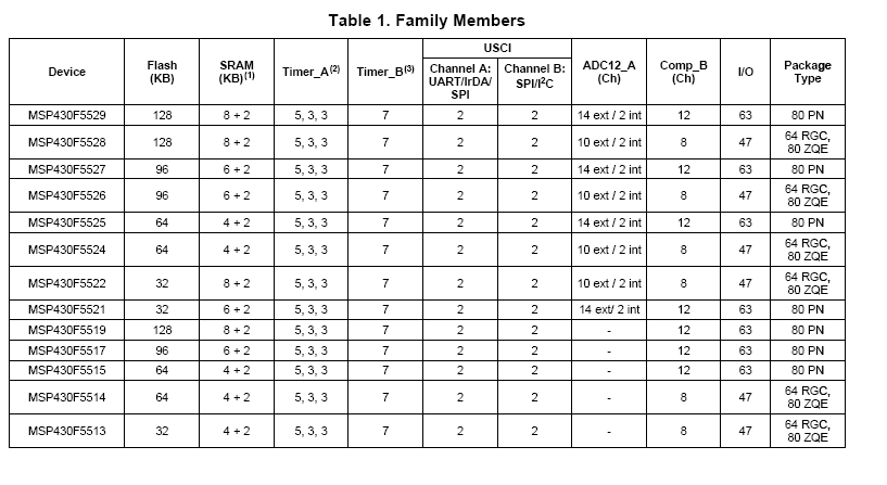

Hi all,
I went and downloaded the code examples for the MSP430F5515 from here: http://focus.ti.com/docs/prod/folders/print/msp430f5515.html#toolssoftware
Specifically I downloaded from the link MSP430F552x C Examples (IAR and CCSv4) (Rev. A). I thought to myself, i'm using a 5515 which doesn't quite match the 552x pattern, but it's there on the TI 5515 page, so I'll give it a shot.
Most of the code seems to compile, but I took the ADC code, as is without modification, creating a new CCS v4 project targetting the 5515 and sticking MSP430F552x_adc_01.c into it as t
he source file. I get a bunch of build errors:
unresolved symbol ADC12CTL0, first referenced in ./MSP430F552x_adc_01.obj  adc_test line 0 1288275292085 1
unresolved symbol ADC12CTL1, first referenced in ./MSP430F552x_adc_01.obj  adc_test line 0 1288275292100 2
unresolved symbol ADC12IE, first referenced in ./MSP430F552x_adc_01.obj  adc_test line 0 1288275292100 3
unresolved symbol ADC12IV, first referenced in ./MSP430F552x_adc_01.obj  adc_test line 0 1288275292100 4
unresolved symbol ADC12MEM0, first referenced in ./MSP430F552x_adc_01.obj  adc_test line 0 1288275292100 5
My gut tells me there is something very wrong with the header file register definitions for the chip... So I dug a little deeper, and opened up the header filed called out by the example code (msp430f5529.h)... sure enough there is a line in there:
 SFR_16BIT(ADC12CTL0);                         /* ADC12+ Control 0 */
and
#define SFR_16BIT(address)  extern volatile unsigned int address
... but the definition of ADC12CTL0 is nowhere to be found... so what gives? Is there some other header I need to include when using the msp430's ADC hardware to satisfy this extern definition? Also, in my ultimate application, I expect I will include the header filed named msp430x551x.h rather than msp430f5529.h but maybe I'm missing something? Hopefully someone can clarify this for me, because I'm pretty baffled at this point.
