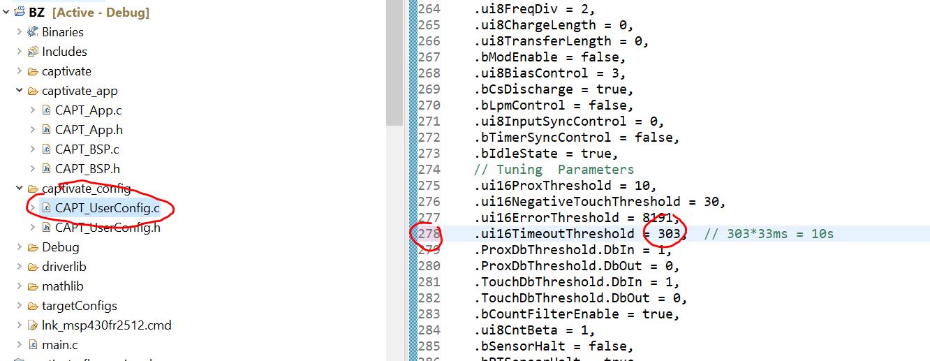

I tested or modified at least four versions of the PCB,It is found that if the external dc source is used, the power supply distance can be a little farther, and it is best to achieve about 5cm.
However, if cr2032 is used for power supply, the distance will be shortened. At present, the best distance is about 3cm and it is not stable.

  • Using your firmware is still about 3cm,And the installation of the battery will trigger proximity sensing, even if the hand left will trigger.It gets worse.
  • If the installation of the battery will trigger proximity sensing. Update timeout parameter in source code. After 10 second the system will be back to normal.
