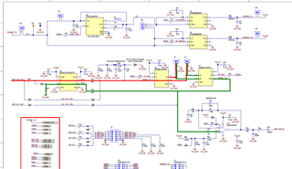

    Let me summarize our board's main changes and known bugs compared to the TI's USS EVM. I think it would help to analyze the problem.
    1) I don't have a bus transceiver 74LVC2T45 used to increase the amplitude of the output signal.
    2) I lost Rterm on the TX path. Therefore, I have two Rterm soldered to the connector where transducers are connected (gold pin connector).
    3) I don't have the highlighted bias resistor. Instead, I have two Rbias (1k) connected to the ground where transducers are connected (gold pin connector).
    Adam
  • Hi Adam,
    We recommend against removing the transceiver because the Tx and Rx circuits are designed to be impedance matched so that when we look back from either transducer, the impedances are the same.  This paper explains why it's important to match Tx and Rx impedances:
    https://ieeexplore.ieee.org/stamp/stamp.jsp?arnumber=4409678
    BR,
    Leo
  • Hi Leo,
    1)
    Thank you for the tip.
    2)
    Would you shed some light? Why do you think this transceiver is essential here?
    I made manual changes to my PCB, and I have the circuit equivalent to the following taken from EVM430-FR6043 but without this transceiver. The zero-flow delta ToF had dropped significantly to 2-3ns (without too much work and any parameter adjustments).
    3)
    Do you have any information regarding this missing application note?
    I want to make changes to my PCB and would like to see what the recommendations are.
    Adam
  • Hi Adam,
    In the development of a gas meter, you will see significant attenuation in the ultrasonic signal when testing in methane(ie. an additional 25dB).  This will have a negative effect on your standard deviation.  A simple way to address this is to increase the excitation voltage.  This can be done without significant modification via the transceiver.
    We recommend following the EVM layout as closely as possible.  Important points for the USS part will be:
    • Keep USS signal traces as short as possible.
    • Do not cross USS signal IN/OUT traces
    • USS traces from IC to amplifier circuit should be symmetric.  If symmetric is not possible, trace length should be the same.  On the EVM, this is from the chip to J9.
    • Keep USSXT close to IC and short traces.
    There are also more general layout guidelines in the datasheet, section 10.
    https://www.ti.com/lit/ds/symlink/msp430fr6043.pdf
    Because these recommendations are straightforward, the referenced app note was never published.
    BR,
    Leo
  • Hi Leo
    I thought I had finished this topic, but I have doubts about one of your recommendations.
    I don't know if I understand this correctly.
    Which of the signal paths should be of the same length?
    There is only one amplifier and only one path. Do you mean these two paths:
    CH0_OUT to U9 (pin 7)
    U10 (pin 1) to CH0_IN
    Assuming the paths from J5/J6 to U7/U8 (pin 4,5) are symmetrical, do we have to match the length of these paths:
    U9 (pin 2) to U8 (pin 5)
    U10 (pin 3) to U7 (pin 5)
    Adam
  • Hi Adam,
    The goal is that the impedance when looking back into the circuit from one transducer should be as close as possible to the impedance of the circuit when looking back from other transducer.
    BR,
    Leo
