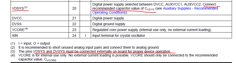

About Pin No.59 DVSYS on the MSP430F6733, if I don't use it, how can I handle it?
I confirmed with SLAA517E, and it shows DVSYS is connected to the GND through capacitor. IS IT RIGHT?
  • Hello takin,
    Please see device datasheet for proper connection of DVSYS and VDSYS. This information is located in Table 6 - Terminal Descriptions and the Auxiliary Supplies - Recommended Operating Conditions table.
  • Hello JH
    I saw the data sheet and it shows follow
    ThepinsVDSYSandDVSYSmustbeconnectedexternallyonboardforproperdeviceoperation.
    If you have another comment, would you show me that.
    BTW the EVB data sheet shows VDSYS connect GND thorough the capacitor.
    What is the proper device operation?
    Also I don't use AUX supplies.
    What should I do?
  • Hello takin,
    Terminal Functions table:
    VDSYS must be connected to DVSYS for device operation. VDSYS must also have CVSYS connected to it similar to how VCORE needs CVCORE.
