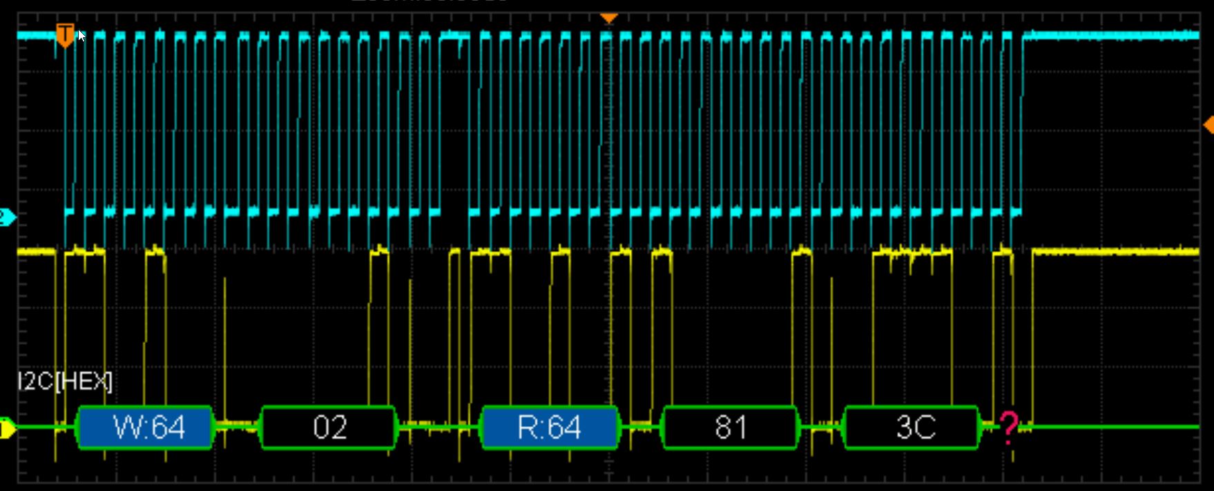

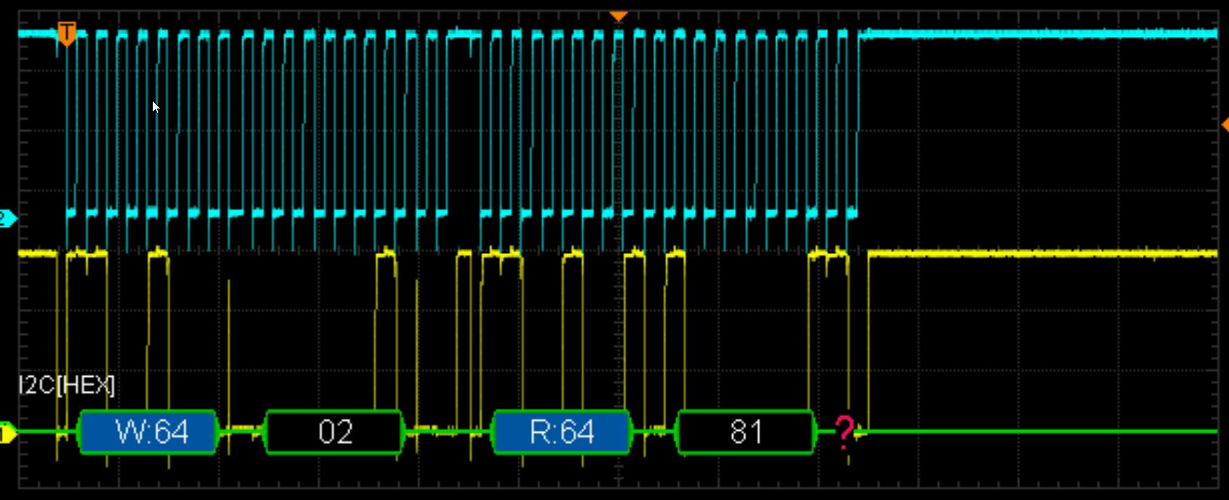

  • I've spent some time preparing the code that shows the case I am writing about. There are three cases:
    Case 1.
    After sending the command, I send a STOP. Then I set the flags UCTXSTT and UCTXSTP, which makes receiving only one byte. But because of the STOP slave "forgets" the command and send wrong answer.
    Case 2.
    After sending the command, I send repeated START. I receive the correct answer from slave, but MSP receiving two bytes.
    case 3.
    After sending the command, I send repeated START and STOP. I expected, that MSP send repeated start, and after receiving one byte send NACK and STOP. But MSP send first STOP and then START (not repeated START).

    void i2ctest(void) { volatile uint16_t tmp; prepareDevice(); /* Disable the USCI module and clears the other bits of control register */ HWREG16(EUSCI_B1_BASE + OFS_UCBxCTLW0) = UCSWRST; /* Clock prescaler - freq: 100KHz */ HWREG16(EUSCI_B1_BASE + OFS_UCBxBRW) = 80; /* Set slave address */ HWREG16(EUSCI_B1_BASE + OFS_UCBxI2CSA) = 0x64; /* UCCLTO_0 - Disable clock low time-out counter * UCASTP_1 - UCBCNTIFG is set with the byte counter reaching the threshold. * UCGLIT_0 - 50ns deglitch time */ HWREG16(EUSCI_B1_BASE + OFS_UCBxCTLW1) = UCCLTO_0 | UCASTP_1 | UCGLIT_0; /* * 7bit address * UCMST = Master mode * UCMODE_3 = I2C mode * UCSYNC = Synchronous mode * UCSSEL1, UCSSEL0 - clock source: SMCLK * UCTR Transmitter */ HWREG16(EUSCI_B1_BASE + OFS_UCBxCTLW0) |= UCMST + UCMODE_3 + UCSYNC | UCSSEL_3 | UCTR; /* Reset UCWRST bit to enable I2C module */ HWREG16(EUSCI_B1_BASE + OFS_UCBxCTLW0) &= ~(UCSWRST); /*Send start condition and wait for start/address sending complete */ HWREG16(EUSCI_B1_BASE + OFS_UCBxCTLW0) |= UCTXSTT; while (HWREG16(EUSCI_B1_BASE + OFS_UCBxCTLW0) & UCTXSTT); /* Send command to spi slave */ while (!(HWREG16(EUSCI_B1_BASE + OFS_UCBxIFG) & UCTXIFG0)); HWREG16(EUSCI_B1_BASE + OFS_UCBxTXBUF) = 0X02; while (!(HWREG16(EUSCI_B1_BASE + OFS_UCBxIFG) & UCTXIFG0)); switch (1) { case 1: /* Send stop and wait for sent*/ HWREG16(EUSCI_B1_BASE + OFS_UCBxCTLW0) = (HWREG16(EUSCI_B1_BASE + OFS_UCBxCTLW0) & (~UCTR)) | UCTXSTP; while (HWREG16(EUSCI_B1_BASE + OFS_UCBxCTLW0) & UCTXSTP); /* Send start & stop */ HWREG16(EUSCI_B1_BASE + OFS_UCBxCTLW0) = (HWREG16(EUSCI_B1_BASE + OFS_UCBxCTLW0) & (~UCTR)) | UCTXSTT | UCTXSTP; break; case 2: /* Send repeated start */ HWREG16(EUSCI_B1_BASE + OFS_UCBxCTLW0) = (HWREG16(EUSCI_B1_BASE + OFS_UCBxCTLW0) & (~UCTR)) | UCTXSTT; break; case 3: /* Send repeated start and stop */ HWREG16(EUSCI_B1_BASE + OFS_UCBxCTLW0) = (HWREG16(EUSCI_B1_BASE + OFS_UCBxCTLW0) & (~UCTR)) | UCTXSTT | UCTXSTP; break; } while (!(HWREG16(EUSCI_B1_BASE + OFS_UCBxIFG) & UCRXIFG0)); HWREG16(EUSCI_B1_BASE + OFS_UCBxCTLW0) |= UCTXSTP; tmp = HWREG16(EUSCI_B1_BASE + OFS_UCBxRXBUF); while(1); }
  • The only difference between your code and driverlib's EUSCI_B_I2C_masterReceiveSingleByte() is that the latter uses two separate instructions to clear UCTR and to set UCTXSTT+UCTXSTP. I thought was just to be able to use "&=" and "|=", but your waveform shows that the hardware applies the TXSTP to the transmit transaction.
    So it appears when using a repeated start, you actually must change UCTR before TXSTP:
    	case 3:
    		HWREG16(EUSCI_B1_BASE + OFS_UCBxCTLW0) &= ~UCTR;
    		HWREG16(EUSCI_B1_BASE + OFS_UCBxCTLW0) |= UCTXSTT | UCTXSTP;
