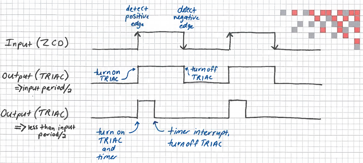

  • Hello Alex,
    Revisiting your ZCD circuit, you'll have a digital output signal (PWM) with basically a 50% duty cycle (since half the sine wave is positive and the other half is negative assuming no DC offset) and variable pulse width (based on the AC period). I don't understand what you mean by "synchronizing the PWM to sine wave". There will be propagation delay introduced by the ZCD and how fast the edges of the PWM are detected by the MSP430, but it's consistent - meaning that the effective difference between the transitions shouldn't be affected by the propagation delay (it's there at the beginning and end of the pulse so it subtracts out). If you're asking how to measure the PWM on/off times (should be nearly the same as mentioned earlier) and relate that to the frequency/zero-crossings, it should be easy to accomplish using the timer module in Capture Mode (described here in the user's guide). I don't think you need the comparator module at all.
    James

  • alexander argollo said:
    I got success, as you advise me, to implement ZCD detection using only Interrupts (Port P1 Vector) and a specific electronic circuit. I working right now to adjust the clock and delay to the TRIAC gets turned off inside of the period of ½ wave.
    Great! Looking at your code, I would not adjust your DCO frequency on the fly. Instead, I would highly recommend fixing the DCO frequency and using a timer to adjust how long the TRIAC gets turned on/off inside the input period from the ZCD. This approach should be much easier and more stable.
    I'm happy to see you've got the port interrupts working to detect the ZCD detection - nice work! Now, let's assume that you want the output signal to the TRIAC to equal exactly half the ZCD period. Using your port interrupts, you could start by configuring the port interrupt to fire on rising edge. Then, when this happens, turn on the TRIAC. In your code immediately after this, you'd reconfigure the port interrupts to fire on falling edge. Then, when that interrupt fires, you'd turn off the TRIAC.
    Assuming you'd like the pulse-width to be less than half the input ZCD period, then you'd want to use a timer. After configuring the port interrupt to fire on rising interrupts from the ZCD input, start the timer when the interrupt fires and turn on the TRIAC. Then, when the timer interrupt fires after a certain delay, turn off the TRIAC output. Then, start over waiting for the next rising edge input.
    Does this make sense? Maybe I'm missing something. See the figure below illustrating what I've described. Again, I would recommend using a fixed DCO frequency.

  • HI Guys, I´ll close this post. I have success to understanding a ZCD method!
    I´ll open a new if necessary to explore better about clock and frequency division method for use in PWM wave.
    Thank you all for helping me.
