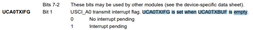

1. With interrupt,the UCB0RXIE & UCB0TXIE are set for receive & transmit interrupt. so when the data is received and transmit the ISR will call i.e USCIAB0TX_VECTOR. I am confused with USCIAB0TX_VECTOR triggering. I refer the user guide it mentions that with start condition generated the TXIFG flag will be set and UCTXSTT is cleared once ACK receives from the slave. On the ISR they haven't cleared the TXFIG flag once the first byte is loaded but cleared on second triggering. I check if the triggering is due to TXIFG so I clear once the first byte is loaded but it triggers again, I also see on second triggering the UCTXSTT was cleared. I want to know on what situation the USCIAB0TX_VECTOR ISR will call ?
2. On the polling method, I have polled while(!(UCB0STAT & UCBBUSY)); to check if the bus is busy or idle data transfer. If I poll the while (!(IFG2 & UCA0TXIFG)); it doesn't send the first byte but only send the address and start bit. what I am doing wrong in this case?

while(!(UCB0STAT & UCBBUSY)); //working /* with while (!(IFG2 & UCA0TXIFG)); not working */
UCB0TXBUF = WHO_AM_I;
while(!(UCB0STAT & UCBBUSY)); /* with while (!(IFG2 & UCA0TXIFG)); not working */
