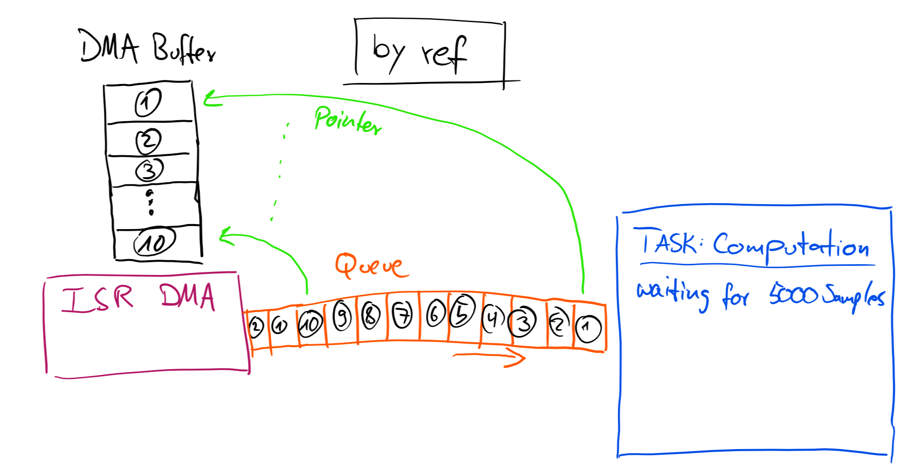

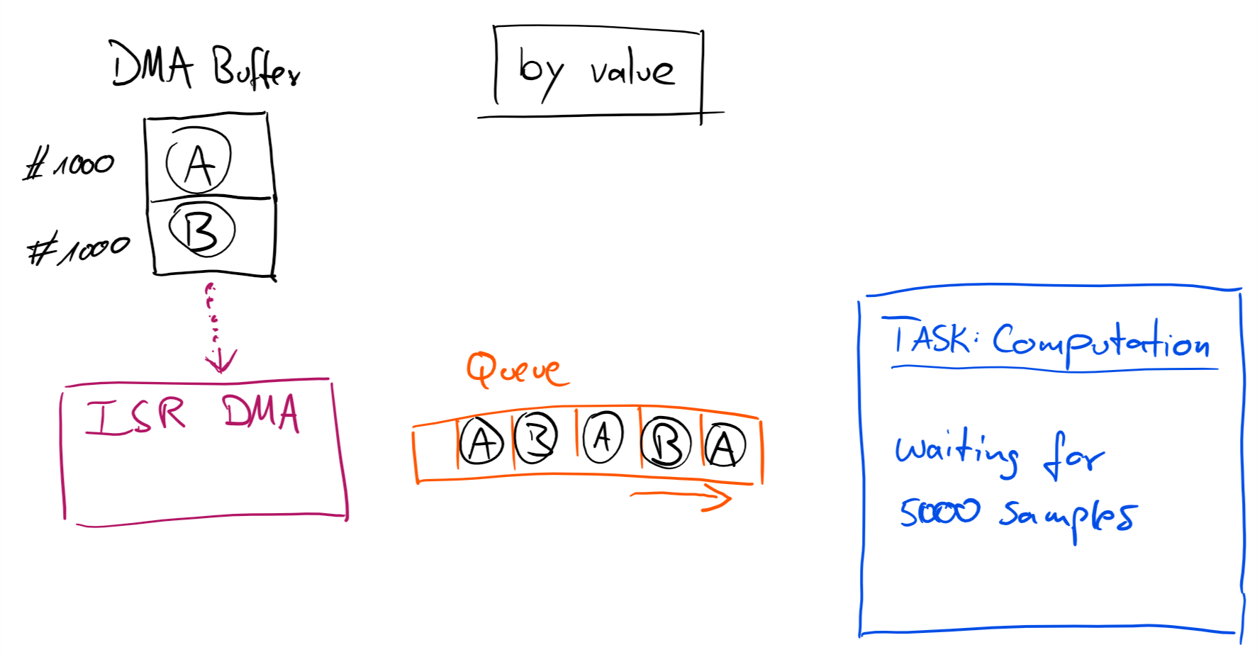

    Maybe this two picture shows my purpose. The first picture shows the current situation, I pass the every 1000 samples by value via queue to the computation. It works but it needs to much SRAM.
    The best would be to pass s pointer to every 1000 samples (to every buffer) via  queue to the computation. When the first 5 pointer (sample 0...5k) arrive they will be used for computation. Meanwhile, the next 5k (5k...10k) samples will be collected and send via pointer in the queue. At this time the first 5k (0...5k) samples or the first 5 buffers were already used for computation. Now they can be filled with new samples from the ADC/DMA:

    From the first picture, you can still pass the DMA buffer by reference right. Maybe I am missing the point here of why you can't pass the buffer. The only concern that I would have is, can you process this buffer soon enough that it is available for the next transaction.
    Sai
    the problem of why it can't work with the "passing by reference" methode is that I need ten DMA buffer not only two (A and B). In the second picture I tried to explain it. With only two buffers I have the problem that I can't pass 5000 samples to computation by reference. After the second (B) buffer is full, the first will be overriden.
    Do you know what I try to say?
    The driver is configuring the DMA in ping pong mode. This means that the DMA will copy data to the ping buffer for one transcation and for the next transaction it will copy data to pong buffer, then to the ping buffer and so on. The DMA cannot be configured to use more than 2 buffers in ping-pong mode.
    The CPU will have to copy data from the DMA buffers (in your figure Buffer A and Buffer B) to other locations if needed.
