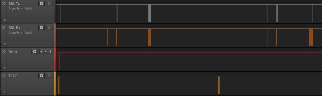

  • Thanks, this nearly works for me. I can get it to upload a program on the second attempt. I have to run the script, watch it fail, disconnect the reset pin then run it again so that it does not re-invoke the BSL. I noticed when the BSL is invoked the Tx line on the MSP430 is driven low for a moment and I wonder if this is causing communication problems.
    I get the following interaction:
    BSL Scripter 3.4.0.1
    PC software for BSL programming
    2019-May-29 15:26:35
    Input file script is : C:/Users/rtaylor/Documents/MSP430 BSL Scripter/BSL-Scripter-v3.4.1/test/BSL.txt
    MODE MSP430F6XX INVOKE UART 9600 PARITY COM9
    VERBOSE
    Verbose mode is now on!
    DELAY 1000
    Delay 1000 ms
    TX_BSL_VERSION
    [80] [01] [00] [19] [e8] [62]
    <00> <80> <02>
    DELAY 500
    Delay 500 ms
    RX_PASSWORD
    [80] [21] [00] [11] [ff] [ff] [ff] [ff] [ff] [ff] [ff] [ff] [ff] [ff] [ff] [ff]
    [ff] [ff] [ff] [ff] [ff] [ff] [ff] [ff] [ff] [ff] [ff] [ff] [ff] [ff] [ff] [ff]
    [ff] [ff] [ff] [ff] [9e] [e6]
    <3b> <04> <e4>
    DELAY 2000
    Delay 2000 ms
    RX_DATA_BLOCK BSL_Test2.txt
    Read Txt File : C:\Users\rtaylor\Documents\MSP430 BSL Scripter\BSL-Scripter-v3.4.1\test\BSL_Test2.txt
    [80] [20] [00] [10] [00] [40] [00] [81] [00] [00] [3c] [b1] [13] [44] [00] [0c]
    [43] [b1] [13] [00] [00] [1c] [43] [b1] [13] [3e] [00] [32] [d0] [10] [00] [fd]
    [3f] [03] [43] [3c] [0a]
    <3b>
    [ACK_ERROR_MESSAGE]Unknown ACK value!
    [80] [7c] [00] [10] [d0] [ff] [00] [14] [40] [14] [40] [14] [40] [14] [40] [14]
    [40] [14] [40] [14] [40] [14] [40] [14] [40] [14] [40] [14] [40] [14] [40] [14]
    [40] [14] [40] [14] [40] [00] [40] [b1] [00] [04] [00] [b2] [40] [80] [5a] [5c]
    [01] [d2] [d3] [04] [02] [d2] [e3] [02] [02] [80] [18] [f1] [40] [a0] [86] [00]
    [00] [81] [93] [02] [00] [03] [20] [81] [93] [00] [00] [f4] [27] [91] [83] [00]
    [00] [81] [73] [02] [00] [81] [93] [02] [00] [f9] [23] [81] [93] [00] [00] [ea]
    [27] [f5] [3f] [03] [43] [03] [43] [ff] [3f] [03] [43] [1c] [43] [10] [01] [4b]
    [25]
    <80> <02> <00> <3b> <05> <c5> <94>
    [ERROR_MESSAGE]BSL Password is error!
    Time elapsed of writing 148 bytes : 0.01895 seconds
    Speed of writing data :7.629(kB/s)

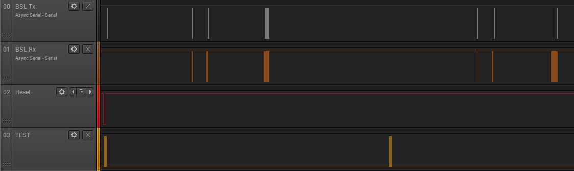

    After this I disconnect the reset signal and get this successful interaction:

    Here is a timeline of the interactions

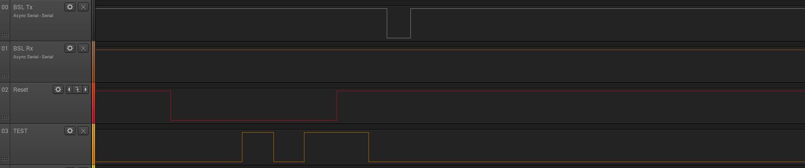

  • Hi Matt,
    Is the factory default MSP430 bootloader supposed to drive the BSL Tx pin low for a moment after invocation? It is this that seems to disrupt the communication between the third party scripter and MSP430 as I have added an RC with diode on a MOSFET to block this initial signal for around 100ms after activity on the RESET pin and now I get reliable operation. This seems like a workaround requiring more PCB space rather than a solution though.
    For those with similar behaviour the BSL password seems to change every time a program is uploaded so I send the default password twice, once to erase everything and once to log in.
    Robin

  • I have found a simple software fix for the third party mod of the BSL scripter. The hard part is convincing visual studio express to build the project but after that simply find the invoke sequence in UartComm.cpp and replace the delay at the end with
    close();
    PLATFORM_DELAY(500);
    port.open(c);
    Maybe flushing the comms buffer or some such before sending commands would be a better solution but I have already spent way too long on something that really should have been done by TI from the beginning.
    Now I can program the MSP430F6736 with CP2102 without any additional components.

  • Hi George,
    You raise a good point about closing the serial port. I guess it leaves DTR vulnerable to whatever UART IC is being used at the time to determine the state of DTR. I have changed it to instead wait half a second, then flush the serial buffer. It should only attempt to read bytes that are already in the buffer so hopefully won't affect micro-controllers that don't send junk characters. I have never seen "boost" before (I already hate it) so I can't be certain that this will work for everyone. It is concerning though that a single junk char can kill the unmodified program. For reference the Tx asserting manifests as 1 byte in the serial buffer.
    As for sharing my copy of the project, I am happy to do it, just it seems very unstable. I can't use VS community so I have used VS express 2013 to get it into a state where VS express 2017 would recognise it and then successfully build it. Overnight my PC decided to make 2013 my default so the next day it opened in 2013 by accident at which point 2017 no longer recognised it. I had to delete the .vs folder to re-target to 2017 at which point it works again. I don't know much about visual studio so it was almost entirely luck that made it build. So far the exe works every time on my MSP430F6736 with CP2102. I have no other micro-controllers to test it on though.
    So having said that if you still want this project I have never uploaded publicly to GitHub before. Am I supposed to add it to the existing project or do I upload to a completely new one? The image below contains all the code I've written so it's not a huge change if someone wants to add it to their 2017 community project.
