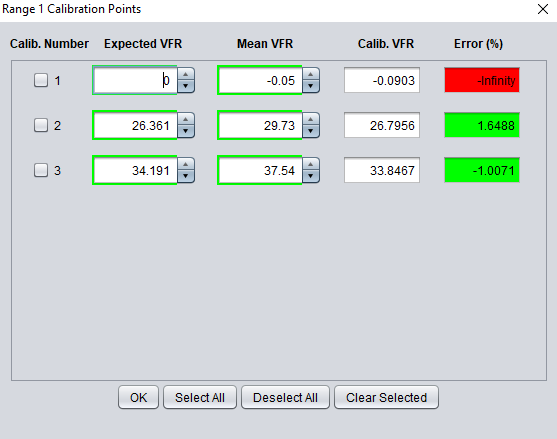

For the calibration, how do i set the 0 ? I've a mean value of -0.05 at 0 liter/h

    2. In order for this to work, you need to set the flow minimum(from the main calibration tab) to a negative value that handles the most negative value you will see.  The error % makes sense as infinity since this is calculated with Vcalculated - Vexpected / Vexpected, so this is dividing by 0.

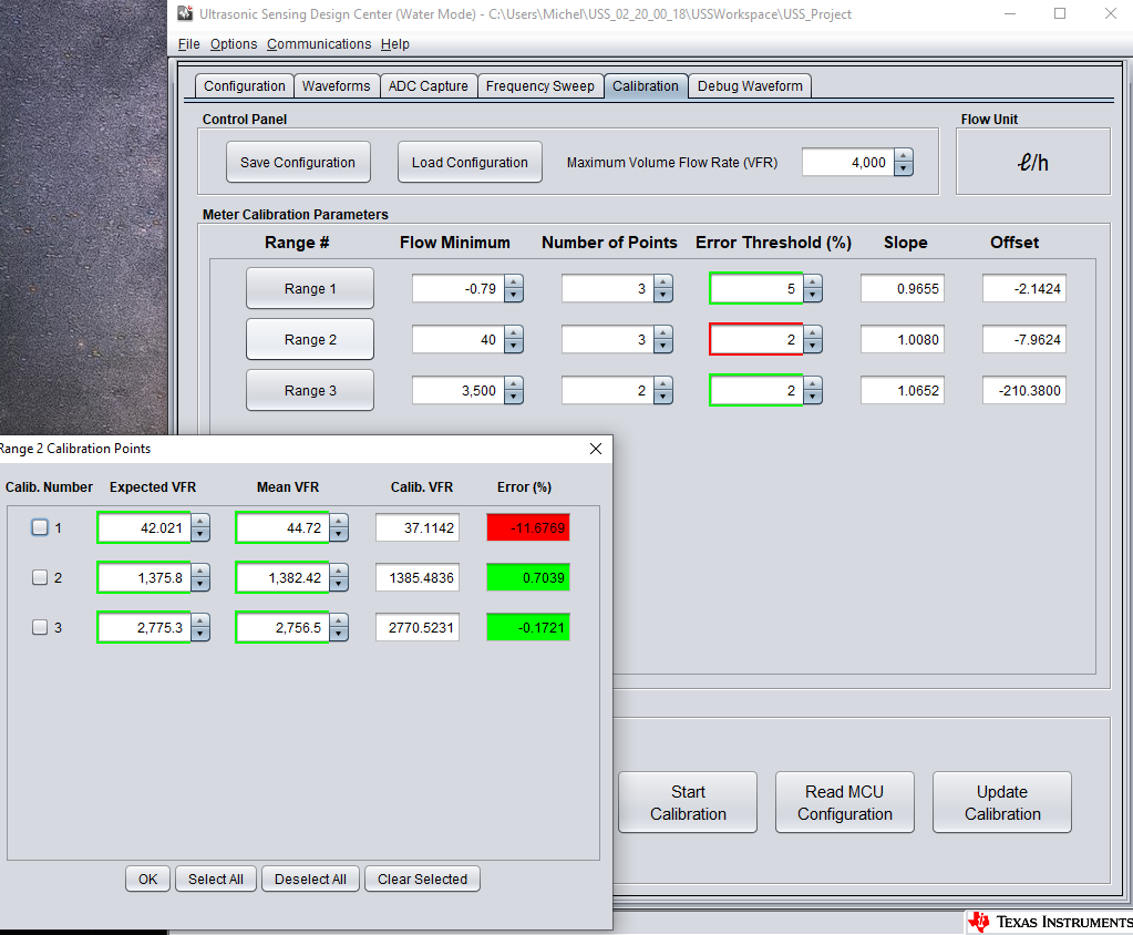

    I don't understand why i've so much difficulty to make the calibration. I've found something weird
    This is the current parameters :
    This is a ADC  Caputre at 0 L/h
    From the ADC i think my settings are OK

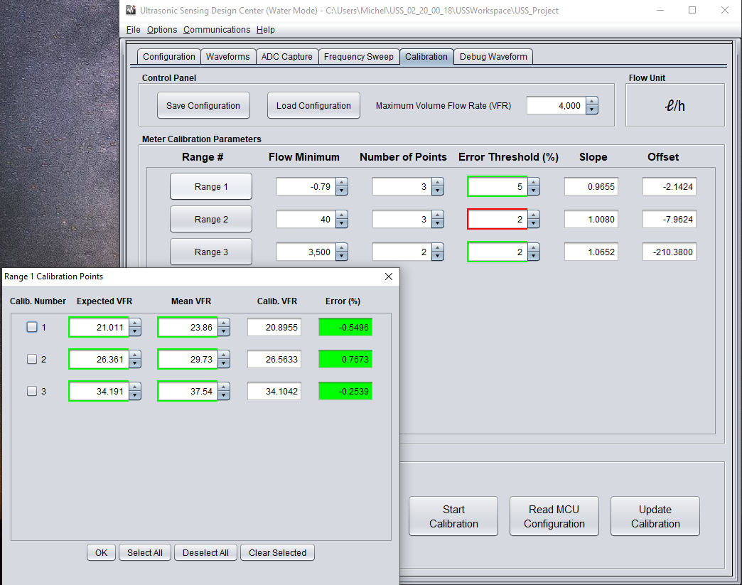

    Then, all my calibration points
    First problem, Why the error stay at 0% at range 3 calibration points 1 and 2 ?

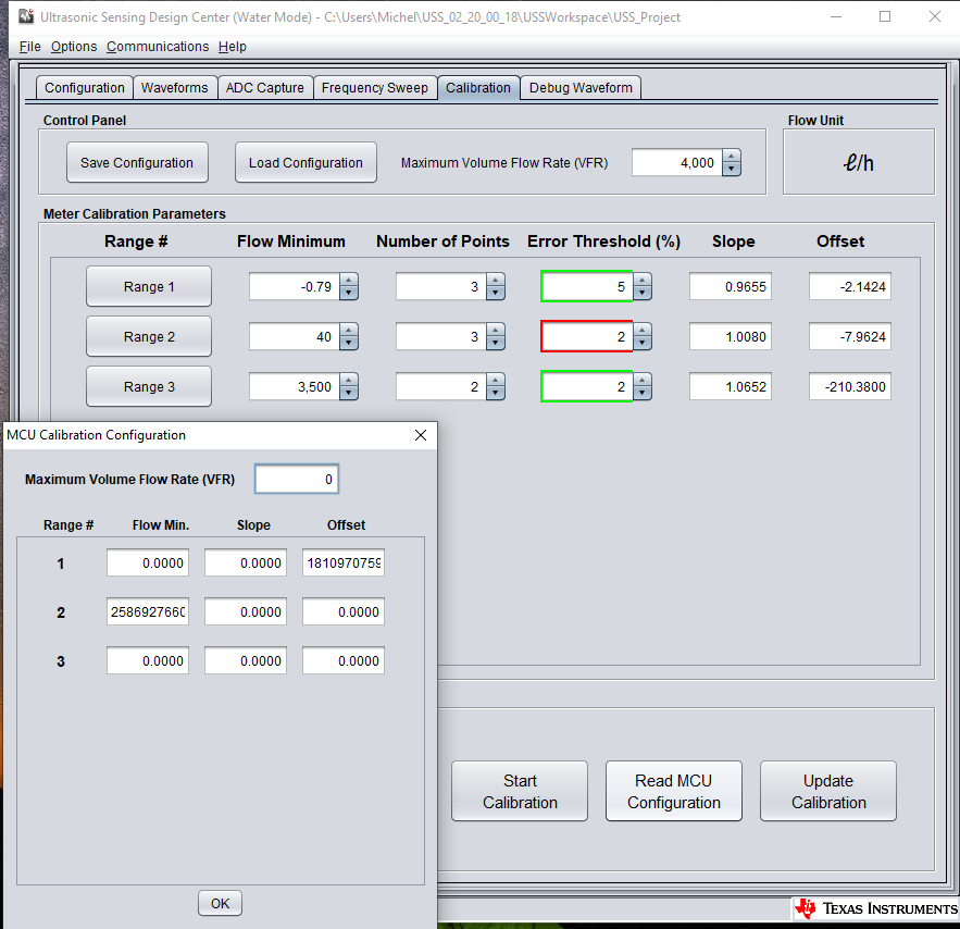

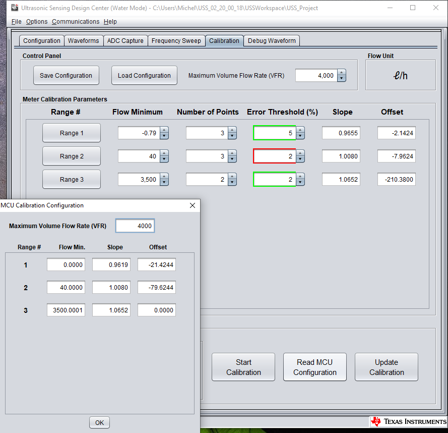

    I generate the headers, rebuild the project, flash my card
    Then i "Read MCU Configuration" and the value are not correct at all, why ?
    if I "Update Calibration" and then "Read MCU Configuration", the value are still not the right one, why ?

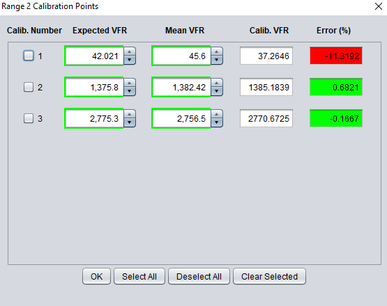

  • Hello Maxime,
    It looks like you have your range 2 calibration points set too wide, which is why the 42.021 point cannot meet the expected error. For range 2, you may want to change the range to something like 42lph to 400lph. If needed, you could add another calibration range to ensure you get the accuracy required across all ranges.
    I also notice that you have the maximum VFR set to 4,000, but your actual maximum is higher. You could set this higher, but it actually shouldn’t have any effect. I think this is just used for the GUI checks.
    In the case of range 3, you only have 2 points so the theoretical error is zero in a linear regression model.  If you add more points in this range, you will see this change.
    In regards to the update calibration not taking your data. I think this is likely due to #define USS_ENABLE_VFR_METER_CALIB being set to false in your USS_userConfig.h file. When you generate the headers, you need to ensure that “Adv. Calibration Table” is checked on the waveforms tab for this to be set to true in the header file. Alternatively, if you generated the header files without this checked, you can just manually set this to true in USS_userConfig.h with the code below.
    //Setting USS_ENABLE_VFR_METER_CALIB to false will result in unexpected behavior
    //between the device and the calibration tab of the GUI
    #define USS_ENABLE_VFR_METER_CALIB                    true
