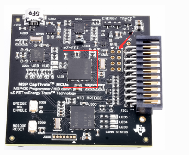

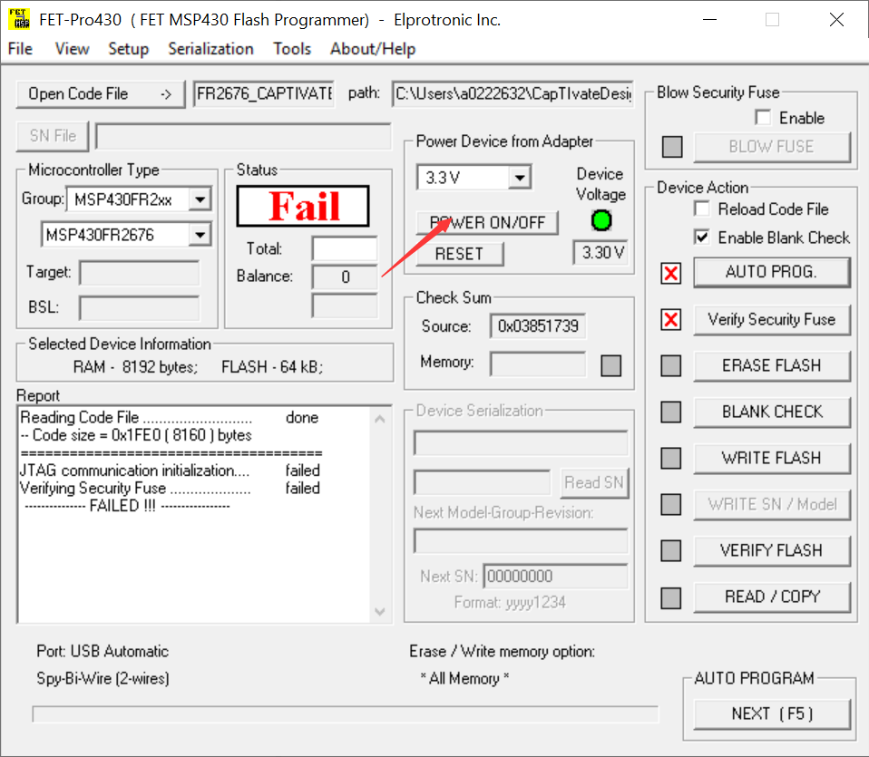

I have an CAPTIVATE-PGRM, together with an CAPTIVATE-FR2676 and an CAPTIVATE-BSWP.
I was not able to connect the Captivate Design-Center with the EVAL-Kit, so I tried so flash the firmware of the BSWP-Example manually:
I tried to flash the FR2627 Board trough CCS, but CCS wanted to update the Firmware of the eZ-FET Debugger.
I triggered the update, but now it has to be 'recovered'.
If I want to flash/debug the BSWP example in CCS (after pressing 'BRIDGE BSL ENABLE' + 'BRIDGE RESET', and then releasing 'BRIDGE-RESET' while keeping 'BRIDGE BSL ENABLE' pressed), I get the following error:
"Error initializing emulator: One of the connected MSP-FETs / eZ-FETs debuggers needs recovery. Select 'Recover' to start the recovery process. Note: Only one MSP-FET / eZ-FET debugger can be connected to your system during recovery."
In that window I can press 'recover', if I press 'recover' I get the following error:
"MSP430: Error initializing emulator: One of the connected MSP-FETs / eZ-FETs debuggers needs recovery. Select 'Recover' to start the recovery process. Note: Only one MSP-FET / eZ-FET debugger can be connected to your system during recovery."
