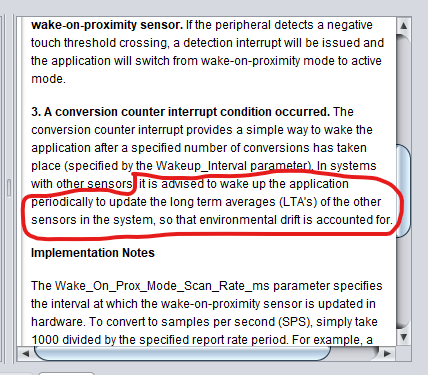

    1. I do not advice you disable wakeup interval. Reason is attached.
    2. For my setting, every 33ms, it will scan for a short time. Please check if it is caused by this reason. You can increase the scan rate to decrease the current consumption.
    Eason

  • Hi Vishal,
    Why don't you use the timer supplied in CapTIvate Technology? Are you very care about average power consumption and the pick power consumption?
    My advice is that if you want your device react stable, you can't turn off the scanning for 10s.
    You don't need to take care of LTA. The lib will help you.
    Maybe you can use wake on Pro mode, it can save the power consumption. You can treat it as a button. If you press it, it will wake up to scan other buttons. Otherwise, there is no feedback if you touch other buttons directly. But EVM430-CAPMINI doesn't has one. You can use a button to simulate.

  • Hi Vishal,
    The first priority of CapTIvate is stability, which come out the customer experience. I really advice you to use all the choice supplied by our GUI which has been tested by TI.
    You can find the information you need in Ultra Low Power chapter of the UG
    Hope it can help you. I will close this thread.
