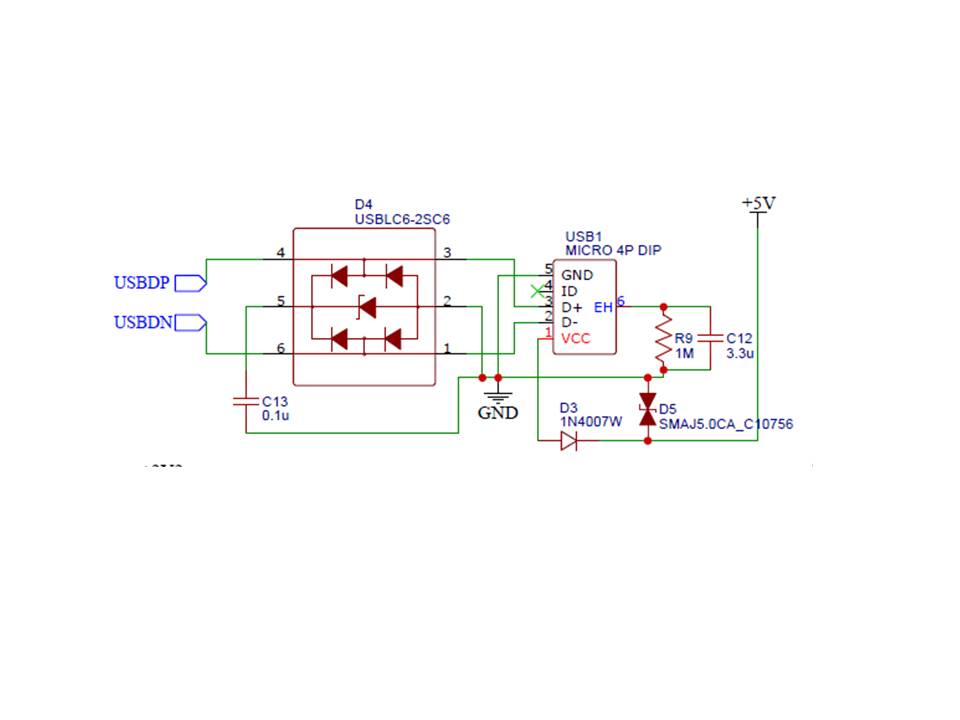

Hi Guys
Customer asked us to confirm that his configuration will allow Firmware updates via USB (on the main controller MSP432E401Y).
USB +5V regulated to 3V3 with TPS73733DCQR to MCU

Hi Rodney,
From what I can find for detailed information on MSP432E401 USB, I believe the USB connections are correct, however, I'm a little confused about the ESD suppressor connections.
Let me check first with a few folks to make sure this design is good to go.
Also, didn't know if customer was aware, here is a thread about example code to invoke BSL from the application.
And link to MSP432E Simplelink BSL guide.
Hi Rodney,
C12: please change to 3.3nF.
R22, R23: consider to connect to VBUS
