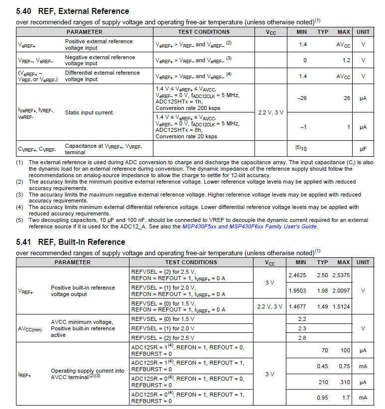

When REF is added from the outside, the total current consumption is the same as the current system, but when switching to internal REF
20 times more current
Please let me know if any settings are missing.
//ADC12
    ADC12CTL0 = ADC12ON | ADC12SHT0_9| ADC12REFON | ADC12REF2_5V; //
//    ADC12CTL0 = ADC12ON | ADC12SHT0_9; //
    ADC12CTL1 =ADC12SSEL_3 | ADC12SHP; //
    ADC12CTL2 =ADC12RES1_L | ADC12REFOUT; //
//    ADC12CTL2 =ADC12RES1_L ; //
    ADC12MCTL0 =0x00 | ADC12SREF_2; //
    ADC12MCTL1 =0x01 | ADC12SREF_2; //
    ADC12MCTL2 =0x02 | ADC12SREF_2; //
    ADC12MCTL3 =0x03 | ADC12SREF_2; //
    ADC12MCTL4 =0x04 | ADC12SREF_2; //
    ADC12MCTL5 =0x05 | ADC12SREF_2; //
//    ADC12MCTL0 =0x00 ; //
//    ADC12MCTL1 =0x01 ; //
//    ADC12MCTL2 =0x02 ; //
//    ADC12MCTL3 =0x03 ; //
//    ADC12MCTL4 =0x04 ; //
//    ADC12MCTL5 =0x05 ; //
//    ADC12MCTL5 =0x08 | ADC12SREF0; //debug
    ADC12IE =0x00; //
    ADC12IFG =0x00; //
//REF
REFCTL0 &= ~REFMSTR;
