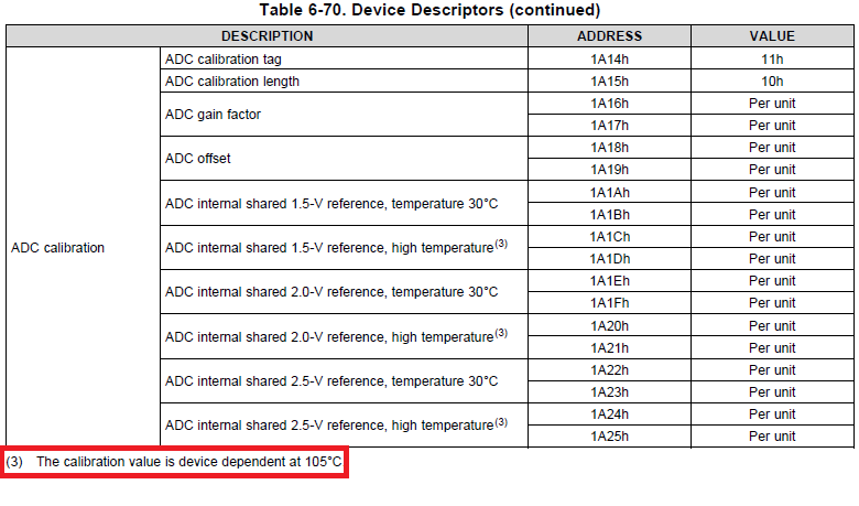

    (1) According to FR2355 datasheet (Rev.D,SLASEC4D), ADC internal shared reference is described as following.
    In above table, it isn’t shown 85℃ at high temperature and this calibration value is device dependent at 105°C from note(3).
    About the FR2355 ADC internal shared reference at high temperature,
    Which is the condition at 85℃ or 105℃?
    (2)Can we use FR2355 ADC internal shared 2.0-V reference as temperature sensor calibration data?
    If possible, is calculation formula same as FR2676 sample code(msp430fr247x_ADC12_16.c) that is using 1.5V-reference ?
    Also is there any concern on using 2.0-V reference as temperature sensor calibration ?
    Tao_2199
  • Hi Tao,
    so on the FR2355 datasheet (Rev.D,SLASEC4D) the word sensor is also missing and the data are refering to 105 degC because teh FR2355 is a 105 degC device.
    My post before referred to FR263x datasheet SLAS942E which is a 85 degC device.
    To the 2nd aspect of your questions. Yes you can use the 2V temp sensor calibration data according the description in user guide but have to align delta temperature accordingly. With small alignments on temperature the code example can be used.
