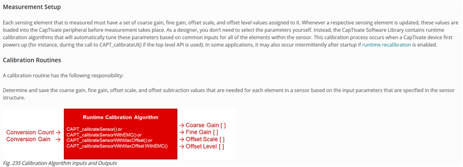

    One of the issues, among several, is I don't see that have performed the initial calibration that is required at power on.  Without the calibration step, the Captivate peripheral won't operate very well, if at all.  So I will make some recommendations here to put you on the right track.
    Here is what I would suggest.  Take a look at the software library chapter in the Captivate technology guide, "adding captivate to an existing project" starting down the page at step #4. I copied a section of it down below for convenience.
    There it shows you the basic steps and 3 simple APIs required to get everything up and running.  They are CAPT_initUI, CAPT_calibrateUI and CAPT_updateUI.  If you are reading only one sensor you can skip CAPT_updateUI, but, I would still strongly recommend using CAPT_updateSensor() rather than just performing a raw measurement.  CAPT_updateSensor does additional work that is important to filtering the measurements, setting the prox and touch flags and more.  You can always read the "raw" result stored in the sensor's data struct from your callback function (read more about callbacks), which is called automatically from within the CAPT_updateSensor() function. It does all the work for you.
    This was intentional, as the object to be detected may be present on startup. The sensor cannot be calibrated during normal operation for this reason. The nature of the system is such that the object is either present to some degree, or not; it does not become present periodically as would a finger.
    The end-product is to be calibrated once in manufacturing and the calibration values are to be used throughout the product lifetime - in this case the values of the tCaptiveElementTuning structure are retained from calibration. In the field, raw counts are compared to a threshold (with margins of error included to prevent false positives). Also in the application code are other methods of inferring the object presence, but those are outside of the scope of this question. Think of the capacitive sense as a first line of defense.

  • Another thing I'd like to point out is that the code I had provided invokes all the same function calls as your suggestion, aside from three things: calling calibrate, using a timer to drive conversions, and invoking CAPT_updateSensor rather than CAPT_updateSensorRawCount. The calls I make are direct to the CAPT library/ROM, bypassing the CAPT_App code. The timer interrupt appears only to set a flag to indicate to CAPT_appHandler to invoke the CAPT_updateSensor call for each sensor (in my case one sensor). As far as I can tell, that is the only substantial difference. My implementation invokes CAPT_updateSensorRawCount every 5 milliseconds using a SW timer outside of the scope of the code provided rather than using the HW timer.
    From what I can tell the calibration call updates the tCaptivateElementTuning structure for the sensors used, but I admit there could be many other operations that are performed that we as users are not made aware. Those tuning values are what I intend to store for the application use. If CAPT_calibrateSensor performs other work within the hidden Captivate registers, I suppose I could invoke it then restore my saved tuning values. Can you confirm that the call to CAPT_calibrateSensor does indeed perform some required operation?

  • Hi JD,
    Ok, you are fine with how you are doing it.
    Yes, the calibration is required, at least once (either at every power cycle or once in the lifetime and then store the coarse, fine and offset calibration values as described here).
    From the Captivate technology guide:
    Regarding the source code for the Captivate library, unfortunately no.  I will send you a friend request so we can discuss the library details off-line.
