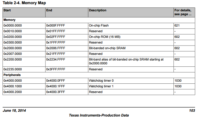

    Using CCS 6.1.3 and a TM4C1294NCPDT I stepping into a MAP_UARTConfigSetExpClk call, the address changed to 0x0100A06E and also got the  "Memory map prevented reading 0x0100A06E [code=0x20000]" message in the CCS disassembly window. I was able to continue stepping until the MAP_UARTConfigSetExpClk returned to the calling C code and the UART is working correctly. In my program MAP_UARTConfigSetExpClk was set to use the ROM based ROM_UARTConfigSetExpClk function.
    Since the UART operates correctly after the ROM_UARTConfigSetExpClk call, I believe the problem is that the ccsv6\ccs_base\emulation\gel\tm4c1294ncpdt.gel GEL script in CCS 6.1.3 has incorrectly specified the size of the TM4C1294NCPDT ROM as 0x8c00 bytes, since the ROM_UARTConfigSetExpClk function starts at offset 0xA06E into the ROM:
        GEL_MapAddStr(0x01000000, 0, 0x00008c00, "R", 0);  /* ROM */
    Looking at the TM4C1294NCPDT datasheet SPMS433B I am not sure how large the ROM is, since Table 2-4. Memory Map shows the ROM starting at address 0x02000000 which differs from the GEL script and the actual functions in ROM:

    Once CCS displays "Memory map prevented reading 0x0100A06E [code=0x20000]", if you continue stepping does control eventually return to your own code and does the UART work?
    Alternatively, does Step Over (F6) on the MAP_ function calls work, as that avoids trying to single step into the ROM functions for which CCS has no symbolic debug information?
