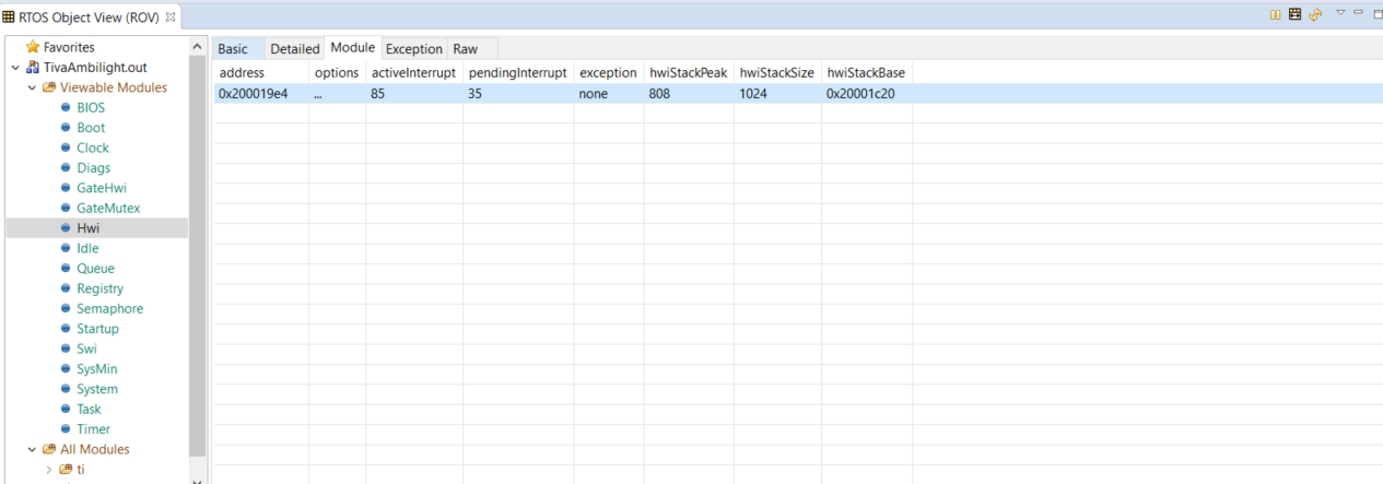

ti.sysbios.family.arm.m3.Hwi: line 1277: E_noIsr: id = 85, pc = 00005a44
Exception occurred in background thread at PC = 0x00005a44.
Core 0: Exception occurred in ThreadType_Task.
Task name: {unknown-instance-name}, handle: 0x20001a10.
Task stack base: 0x20000360.
Task stack size: 0x800.

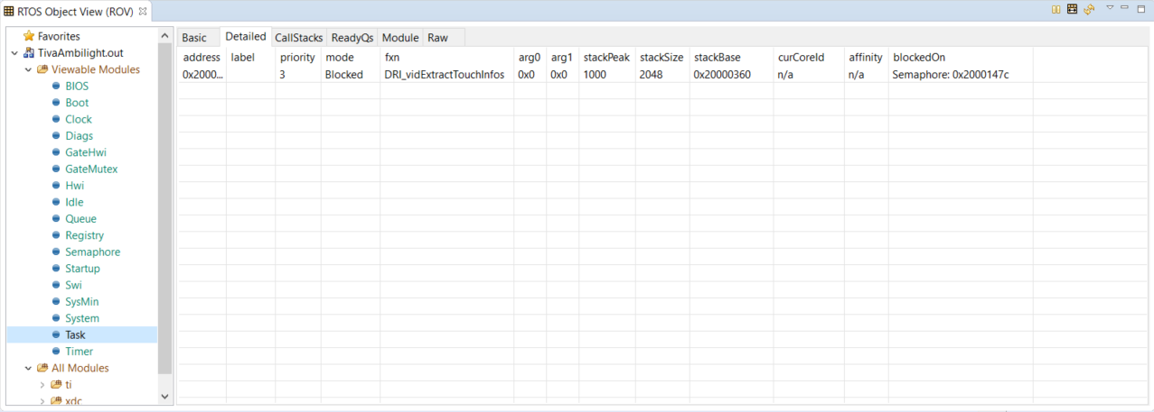

the task is waiting for the interrupt, when I occure the interrupt by pushing the user button linked to PF4 the message above occure.
When I tested the interrupt alone by commenting the task, it work fine.
So as conclusion : task alone works fine, interrupt alone works fine but when I use the task and the interrupt i have the message above :

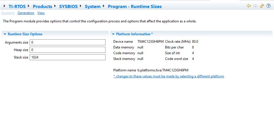

and here is my memory section configuration :
MEMORY
FLASH (RX) : origin = 0x00000000, length = 0x00040000
SRAM (RWX) : origin = 0x20000000, length = 0x00008000
/* Section allocation in memory */
SECTIONS
.text : > FLASH
.const : > FLASH
.cinit : > FLASH
.pinit : > FLASH
.init_array : > FLASH
.data : > SRAM
.bss : > SRAM
.sysmem : > SRAM
.stack : > SRAM
.vtable : > SRAM
Thank you very much for help
    I think you want to use the semaphore on this. In your Hwi gpioButtonFxn0, you will call the semaphore_post() while in the while (1) inside the DRI_vidExtractTouchInfos you will call the semaphore_pend(). After the semaphore_pend() is called, the task will not execute further unless it receives a semaphore handle from the gpioButtonFxn0.
    For details about the semaphore usage please go to chapter 8 in the below user's guide.

  • Hello Charles,
    Thank you for your response.
    I have used a semaphore but i still have the same problem.
    Here is my new code :

     An HWI exception has occurred which can be due stack overflow, no heap or due to illegal instruction execution (due to a bad pointer).
    I will suggest you increase your runtime stack size and your task stack size as suggested earlier.
    Also, you can look into ROV for information that can help debug the issue. In ROV, can you check the Hwi, Task and Heap modules? Check the stack/heap sizes, exception trace.
  • Hello again,
    I applied your suggestion.
    here are some screenshot about my task and how in the ROV :
    Still have the same  problem.
