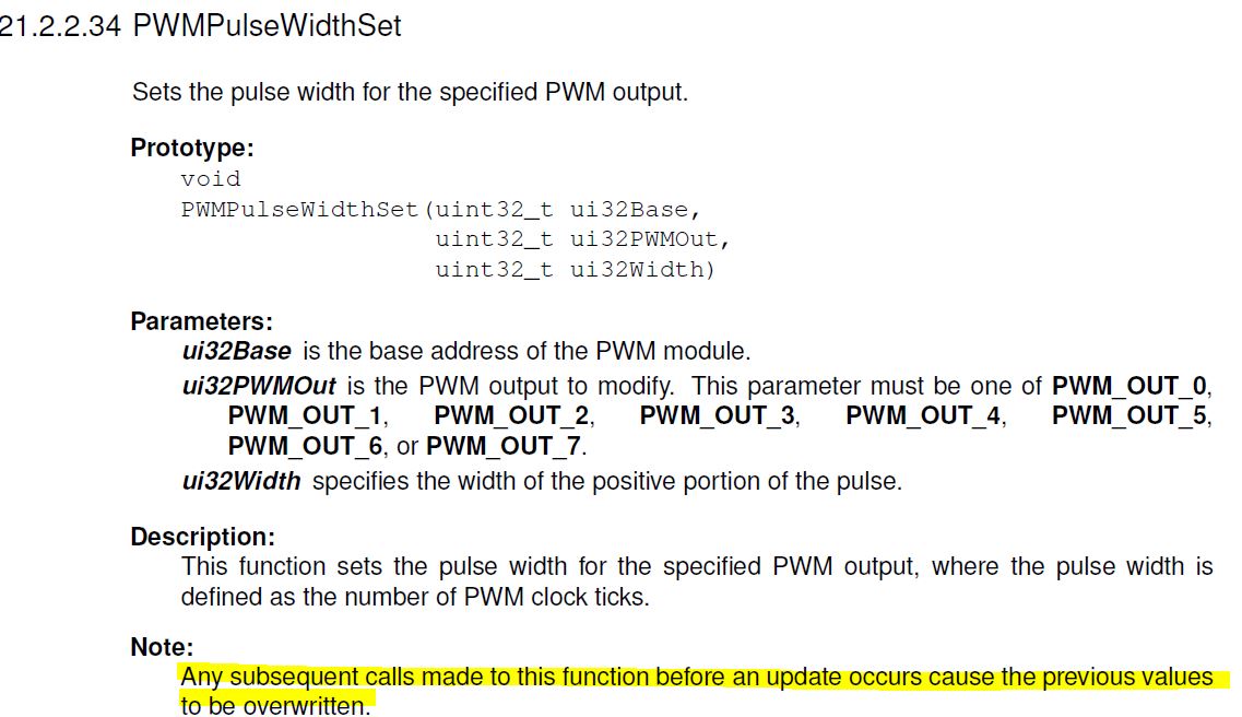

  • Hi Charlie,
      Which cutting_position is stuck at? Between 0 to 5 where is it stuck?
      How fast are you pressing the switch? Is it possible that you press a switch too fast before the SysCtlDelay? For example, you press SW2. You have a SysCtlDelay(10000) added in your code. If you press SW1 before the SysCtlDelay(10000) is counted then the SW1 is missed. In addition, you do not have debounce in your implementation. Without a debounce code, a press on the switch can produce multiple presses (or edges) to the GPIO input. You need to address this.
      I will suggest you add a UARTprintf() or a printf() function to your code so you have a better idea what is going on.
      Another feedback, even though may not be the cause of your problem, is also worth mentioning. You are trying to use PD0 and PD1 as your PWM pins. These two pins are produced by the same PWM_GEN_0. Why do you need to setup PWM_GEN_1? It is redundant.

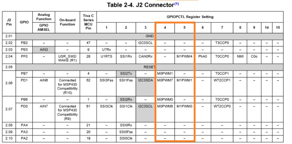

  • Hi Charles,
    Maybe not - it is believed that the '4C123 chart' you presented yesterday proved lacking.    Kindly view this one - right from the LPad's User Manual.
    Your chart did not reveal PD0/PD1 as able to operate under PWM1_BASE!'   (or PWM0_BASE)    Thus poster's  (exclusive) use of  'PWM1_BASE' is correct.   (Nowhere in his code appears PWM0_BASE -  which as you noted - would qualify as 'redundant.')   Indeed - as I've written here in the past - the naming schemes employed for the (many) PWM sources here - 'Could be better!'   (i.e. they stink!)
    Your analysis of the 'ineffective read' of user switches is our conclusion - as well.   Along w/the 'long delay & switch bounce' you identified - we'd prefer to see (some) post switch detection 'time-out' - to insure the stability of switch reads.
    Note too - poster's board is the 'Basic '123 LPad.'    And that board has, 'SO LONG SUFFERED FROM THE DEAD-SHORTS (DELIBERATELY INFLICTED UPON 'PD0-PB6 AND PD1-PB7!'
    Now - should PB6 & PB7 (both) default into GPIO Input Mode - no harm may occur.    Yet we cannot - and should not - 'count upon' so fortunate an occurrence.
    Tag: Reading low cost switches proves a challenge - must be well thought & considered...
  • Hi Charles,
    It's getting stuck in cutting_position = 1.  My suspicion is that ui8Adjust1 and ui8Adjust2 are not being updated thus it's being stuck in cutting_position = 1.
    As for pressing the buttons too fast, I don' think that's the cause.  When I ran the example in Lab 15 to increment/decrement ui8Adjust, it works just fine for PD0.
    I have commented out  PWM_GEN_1 in my code so no difference.
    I tried implementing the UARTprintf() function to display the values in Tera Term.  Now, the buttons don't work at all to advance the DC servos to position 1. Below is the code I used.  Note I commented out the UAARTPrint.  Please let me know if you see anything wrong.  I also setup the tera term serial port to COM 3 and baud rate to 115.2k.  I don't see anything in the terminal window.

  • Hi Charlie,
      Not sure what went wrong. Did you mean that it works if only PD0 is used but not both PD0 and PD1?
      When you said that ui8Adjust1 and ui8Adjust2 are not updated and hence get stuck at position 1, this leads me to the note below.
      Can you try one experiment?
      Change from:
    ROM_PWMGenConfigure(PWM1_BASE, PWM_GEN_0, PWM_GEN_MODE_DOWN);
      to:
    ROM_PWMGenConfigure(PWM1_BASE, PWM_GEN_0, PWM_GEN_MODE_DOWN | PWM_GEN_MODE_GEN_SYNC_LOCAL);
     or:
    ROM_PWMGenConfigure(PWM1_BASE, PWM_GEN_0, PWM_GEN_MODE_DOWN | PWM_GEN_MODE_GEN_SYNC_GLOBAL);
    Below is the description about the local and global synchronization. The synchronization defers the update to the compare register when the counter becomes zero. Try it and see if it makes a difference.

    And do note - your (uncorrected LPad) ties PD0 to PB6 & PD1 to PB7!    That's not good - and should you employ (either PB6/7) as an output - disaster awaits!    Tombstone 'Plague-Istors' R9 & R10 to correct this LPad's (deliberate) inadequacy...
