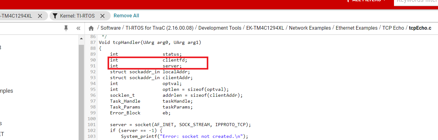

    Although I did notice you are using the NDK_socket() call incorrectly. NDK_socket() will return a SOCK data type and not an int type. And if NDK_socket() fails it will return INVALID_SOCKET. You should have EthernetHTTPSendSocket_1 be of type SOCK. What you have will still run, but it relies on ints being implicitly cast to a SOCK type, so it's best to avoid that.

    Thanks for your suggestions as well, i have now changed the type of the socket. I took the int type from the Tcpecho example where the socket is defined as int. Could be great if its corrected there as well or it might lead to misleading example. Regarding the Http Client API example it really worked out well for me, but i wanted to keep it as simple as possible to reduce the overhead and processing time since my application would be continuously pushing data to the server.

    Finally it is a bit confusing, but the tcpEcho example is actually using the socket return type correctly too. That example includes <sys/socket.h> which is a bsd layer in the ndk. With that header file you call bsd socket calls without the NDK_ prefix and those do return int fds just like bsd sockets. Under the covers those call the NDK_ socket calls too, but some translation occurs to make this work. To sum up, if your socket calls use a NDK_ prefix they will accept the SOCKET type otherwise they will accept int types.
    Sorry for confusing you but I did mean the return type should be SOCKET the first time I responded. There is a SOCK type in the ndk, but it is only used internally in the stack.

    Regarding the Socket type: I took it from here in the example. But nevertheless thanks for the info, i have now made the changes in my code to refer to the right type as suggested, and thanks for your explanation as well :)
