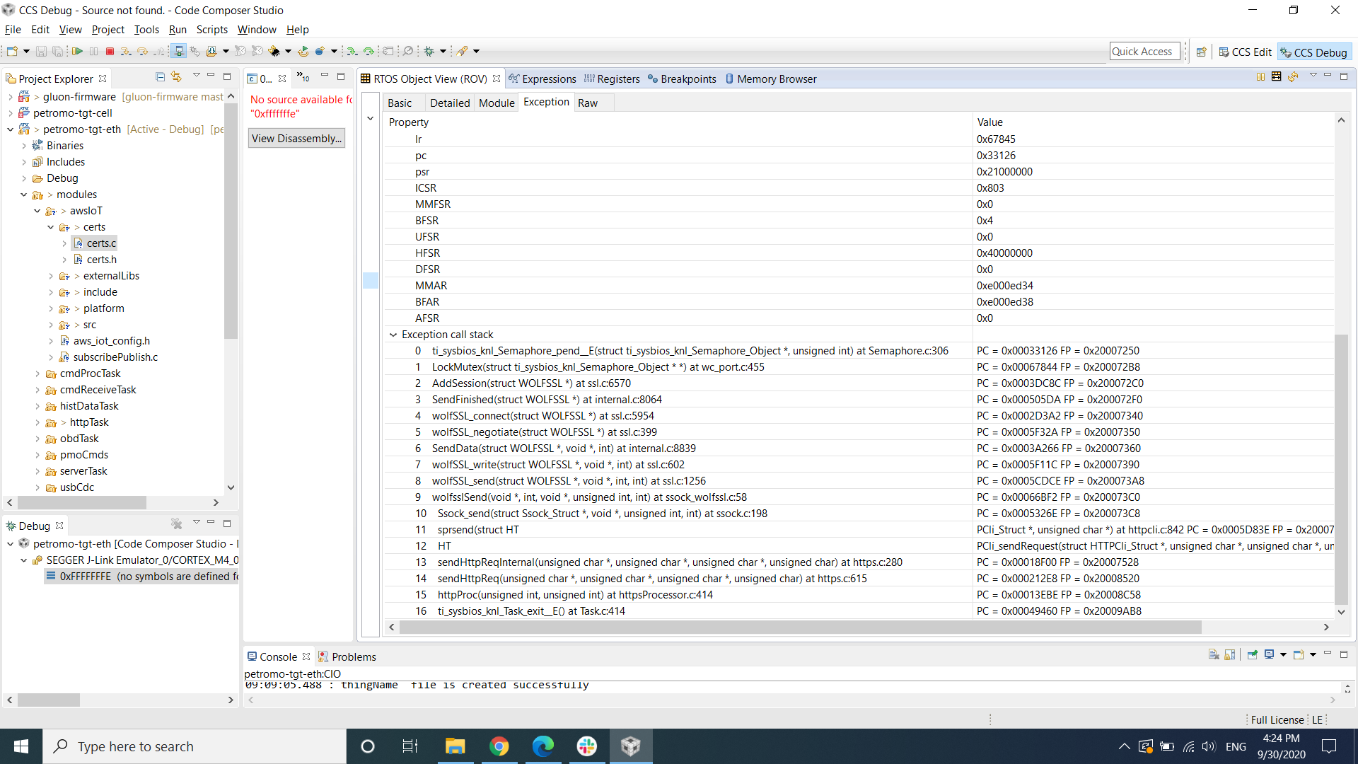

I am using TI RTOS and CCS6 with tm4c129encpdt and xdc tools 3.32
I am using httpcli library for https and mqtt.
I am creating MQTT client and able to send and receive messages. Also, I am able to do https using the same.
My issue is-
When I am creating mqtt client and does not close this connection (mqtt), my https is working fine.
But when I close the connection for MQTT and again the try the HTTPS, my device is going into some hard loop.
For https-
HTTPCli struct and others things are local but TLS for https is global. I am creating TLS only one time and using the same for each HTTP connection.
For MQTT,
Upon closing the connection, I am deleting the TLS for MQTT also along with httpcli handle and all.
I tried with different combinations of HEAP and STACKS but nothing is working out. But when I close MQTT connection and along with it, if I delete the TLS of HTTPS,  and upon creating the new TLS for HTTPS, my HTTPS is working fine.
What I can see is somehow closing and deleting MQTT resources (cli handle and TLS) affecting the TLS of HTTPS. It is failing into some semaphore (screenshots attached)
Let me know
Akhi
      It seems like it has something to do with the TLS and I suppose you are using WolfSSL library, correct? We really don't have the experience with the WolfSSL/TLS. To isolate the problem, can you for experiment purpose not use the TLS? Without the TLS in play, will you be able to close MQTT and start regular HTTP? If the problem is indeed related to the presence of the TLS, then you will need consult with the WolfSSL.
      - What version of the WolfSSL library are you using? Can you try the latest version?
      - I know that the WolfSSL requires quite some stack and heap to operate correctly? You mentioned you increase the stack/heap but did you increase the stack and heap to the right amount? Why don't you try threadStackSize to 32768*2 to see if it makes a difference? Reading your exception call stack, you are getting a imprecise bus fault. Most of the time, this is related to the stack size allocation. Although unlikely, cannot rule out memory leak somewhere in the WolfSSL library or even NDK.
      Please also go through the below video for the common TI-RTOS application debugging tips. I find it quite useful.
