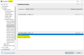

  • Hi Hairy,
    Could I suggest a comment to this affect makes its way into the next release please either in the startup_ewarm.c itself or the associated readme file.
    Yes, we can add that clarification. I will even think to remove the /example/project all together because there is a also a specific project0 for TM4C123 in C:\ti\TivaWare_C_Series-2.2.0.295\examples\boards\ek-tm4c123gxl\project0.
