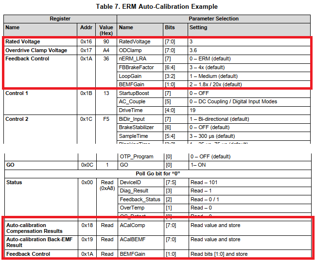

DRV2605: the settings of the registers 0x16, 0x17, 0x1A
Part Number: DRV2605
May I ask whether the settings of the registers 0x16, 0x17, 0x1A are mainly determined the last settings, or is it recommended to determined in the Auto-Calibration stage? 1. Will the settings set in the Initialization stage be overwritten by Auto-Calibration? 2. Will Auto-Calibration settings affect the results of 0x18, 0x19, 0x1A? 3. After Auto-Calibration, if you set 0x16, 0x17, 0x1A again, is it valid?
