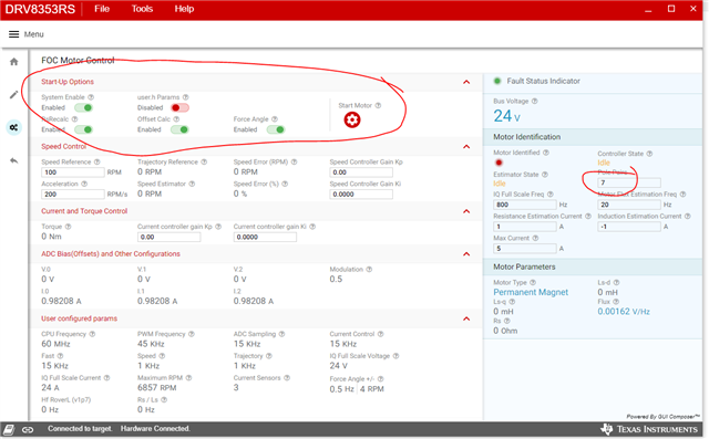

  • Hi Johnny,
    I tried the second board we have and I did have the number of poles set to 4 before, the motor actually has 7.
    I set it to 7 and ran the motor parameter detector again, settings below is what I used. Based on the user manual this is how you get it to detect electrical characteristics of motor, enable RsRecalc, Offset Calc, and Force Angle, then Start Motor.
    It ran the routine once, motor jogged a little, never rotated more than a few degrees but it completed without error. Ran it again, after a few seconds it made the same tapping noise that the other board made, now the fault LED turns on as soon as I tell it to do anything, and fault indicates Gate Dive Fault. I believe this board destroyed itself too.
    I am not sure what is so sensitive about this design, maybe it is the motor I am using. I would expect the board to limit whatever it tries to do to protect itself. I used this motor with fairly low power ST motor dev kit and it was able to characterize and run it fine, so it is not a totally abnormal motor for this sized driver.

  • Nicholas,
    Firstly, to determine whether the driver is broken, unplug the USB, unpower the board, repower the board, and plug the USB back in. Then check to see if the fault LED is still on. If the nFAULT LED does not turn on, this indicates that the DRV8353 is still functional. Make sure that you can enable the device using “System Enable” in the GUI and a fault does not still appear.
    Regarding what occurred: It is likely that the motor parameters were not identified correctly. If the motor resistance (Rs) and inductance (Ls) are too small, the motor may only spin a few degrees or shake in place (‘jogging’ or ‘tapping’ would not be out of the ordinary). The main cause of this is the Resistance and Inductance estimation current is too small or the motor poles is incorrect. If there is not enough resistance estimation current, the algorithm will underestimate the resistance of the motor and this will underestimate the inductance of the motor.
    If the device(s) still work, could you increase your Resistance estimation current and Induction estimation current to a higher values and see if the motor spins during the identification period? (i.e. 3A to 4A for resistance estimation current, and -3A to -4A for inductance estimation current)
    The DRV8353 option is the best recommendation for the gate driver as it is 100-V rated and suitable for the motor application. Will the customer be creating their own FOC code and are just using the DRV8353EVM GUI for FOC evaluation?
