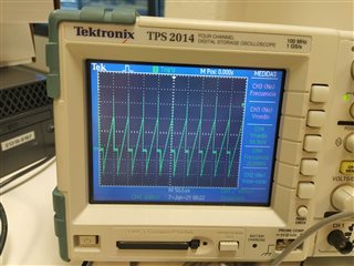

I have two DRV8353RH-EVM boards and am encountering same problem in both. I am using the default settings, I have not touched anything in the board.

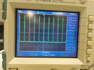

I am generating good INHX and INLX with Simulink for the 3x PWM mode (Default mode). I have measured values in oscilloscope and everything is fine in the ISOF28027 part. However, I am not getting GHX and GLX proper values. Many things are happening.
When i generate an ePWM of %50 duty cycle, for the three phases, I am getting a good result in GHA and GLA. B has no response at all and GLC is oscillating as it is supposed to be. GHC is getting some kind of triangular signal.
When different duty cycles are generated for each phase, we measure in GLC what it was supposed to be measured in GLB. GHC stays the same as before and GLB and GHC have no response. Once again, GHA and GLA work well.
When sinusoidal reference is used, Phases A and B do have some kind of pattern, but it is not exactly the SPWM that it was supposed to be. Phase C stays the same, semi triangular GHC and GLC is constant at about 11 V.
I have been trying to solve the issue the past weeks but find no answer, it's been quite frustrating. I have found nothing in the forums.

    Sorry for the late answer. I understand that this is the schematic we are using because we have touched nothing in the board. Therefore, the resistantces must be those in the schemaatic. If you need me to measure something you just need to ask.
    MEasuring voltages this is what I get for VM=15.6 V: VCP=26.4V, VDRAIN=15.6V and VGLS=12.1V.
    I have attached the oscilloscope images you asked for (images one by one and zip with every image), for every phase. I have one doubt, is the SHX the same as MOTX? I have measured the MOTX because looking at the schematic i didn't found out how to measure SHX otherwise. A has a duty cycle of 10%, B should have a duty cycle of 25% and C should have a duty cycle of %50.

    Could you please provide me with the following (all on the same plot):
    - INLA, INHA, GHA, and GLA with respect to ground
    - INLB, INHB, GHB, and GLB with respect to ground
    - INLC, INHC, GHC, and GLC with respect to ground
    I'd like to confirm with these plots that the input signals are what would we would expect for 3x PWM, as well as to confirm that the outputs are properly following the inputs.

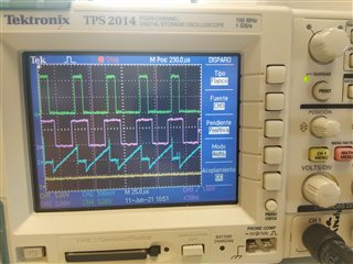

    Thank you for helping me. I have attached the information you are asking for. Blue line is GHX, green line is GLX and pink line is INHX. As mentioned in the data sheet, as I am working with the 3x PWM, every INLX has been set; therefore they all have 3.4V constant value.
    Note that in the graphs every curve is scaled differently. I have done so, so that curves are comparable with each other.
    I hope the information provided helps. Anything you else you may ask, I will be pleased to send you.
    Thanks in advanced,
    Jon

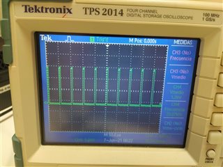

    PS: It is surprising that I am getting in GLC what I am supposed to get in B (not sure if GHB or GLB, but GHL has same duty as expected in B).
    The following is phase A:
    Phase B:
    And phase C:
  • Jon,

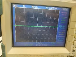

    Could you probe the nFAULT pin during the phase B test and send me the result? I expect that there may be a fault that only shuts down phase B, or there may be some type of intermittent fault.
    Johnny
  • Hi Johnny,
    I will attach the nFault signal picture in the oscilloscope, but it is a constant 3.4 value approximately. Only for clarification, i have created three different PWM for every phase but they are all working together. This is, every signal I sent you yesterday is working with a unique program and could be measured at the same time. I am sending this info because you mentioned the "Phase B test" and so as to let you know that every phase is working while I did the measurement.
    Another thing I wanted to tell you is that I have to boards, and in both is happening the same. I don't know if this helps.
    Thank you in advance,
    Jon
    The nFault signal:

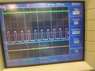

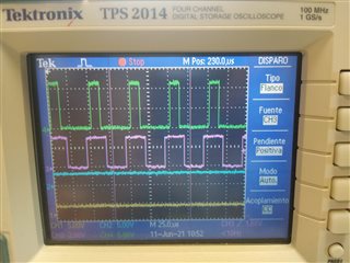

  • Hi Johnny, sorry for the time it has taken me to answer you. I have attached everything you asked for. I don't have an oscilloscope with five terminals, so every signal with nfault is divided in two pics (see description below each photo).
    I hope this helps,
    Take care,
    Jon
    Phase B tests
    INHB is pink. INLB is blue. GHB is yellow and GLB is green
    GLB is green. GHB is yellow. INHB is pink INLB is blue.
    GLB is green. nFault is yellow. INHB is pink INLB is blue.

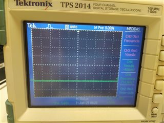

    Phase C tests
    GLC is green. GHC is blue. INHC is pink INLC is yellow.
    GLC is green. nFault is blue. INHC is pink INLC is yellow.

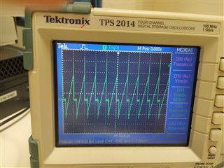

    Measurements with differential probe:
    GHA with respect to SHA (MOTA)
    GLA with respect to SHA (MOTA)
    GHB with respect to SHB (MOTB)
    GLB with respect to SHB (MOTB)
    GHC with respect to SHC (MOTC)
    GLC with respect to SHC (MOTC)

  • Jon,
    The gate voltages show some overpumping (~14V) and negative voltages with respect to the source on LS FET of phase C. This is typically due to having too small of a gate drive current (IDRIVE) or not enough pulldown current when turning the MOSFET off to bleed off the gate capacitance of the MOSFET, which results in extra voltage pumping on VGLS.
    Could you try:
    - Removing R31 to place IDRIVE pin in HI-Z ( increases the gate drive current to 300mA/600mA)
    - Adding a stronger pulldown resistance between the gate and source by adding a 10k resistor at C8-C10 and/or C14-C16.
    See if these changes provide improved gate drive output waveforms.
