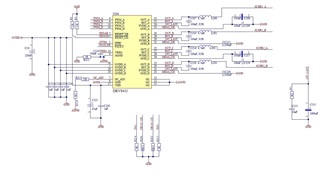

    The OC_ADJ requires a resistor connected to AGND to set the overcurrent limit. If AGND is offset by 2V, the overcurrent fault will be triggered at a lower limit.
    I would have to look at your schematic to understand what can be causing the voltage difference between AGND and GND. Are you able to share the driver schematic?
    Is AGND and GND connected directly on your design? If a resistor is placed, that could explain the voltage difference between the two grounds.
    thank you for the fast response.
    AGND and GND are connected via a 1 Ohm resistor as described in the datasheet.
    The circuit diagram is derived from the TI Eval board.
    Is it correct that the PWM_A to PWM-D, RESAB, RESCD, FAULT and OTW signals refer to AGND?
    Here is the extract from the schematic.
  • Is it correct that the PWM_A to PWM-D, RESAB, RESCD, FAULT and OTW signals refer to AGND?
    That's correct. These signals are powered by the VREG output which is referenced to AGND. However, we recommended connecting these signals to GND if AGND and GND are connected either directly or by a 1Ω resistor as shown in the EVM design and datasheet.
    Can you connect AGND and GND directly. That should help fix the grounding offset. If this does not work let me know and I can provide you with more assistance.

  • Kai,
    Agree with Grzegorz on the selection of the sense resistor.  We have seen issues before with high ESL sense resistors.
    I am going to close this post for now pending results from your EVM analysis.  Please just repost any questions.  If thread is locked, please just click the "ask a related question" button.
