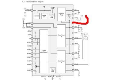

        2. Meanwhile, we found the latest datasheet recommend a resistor paralled on hte PIN VCP, while not in the old verison. Is that a must?
    Thanks!
  • Jian,
    1. The 20us STEP high can remove the minimum twh concern. BTW, we are in process to update twh in datasheet.
    2. The extra 1Mohm can quickly discharge the charge pump voltage in sleep mode to keep the high side FET off in sleep mode. I would add it if re-spin the design.

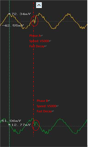

  • Hi Wang,
       Thanks for the consistant support.
       Luckly we captured the waveform while loosing steps,  as below. Please help review and guide how the phase waveform come from.
       Note that: all the abnormal waveform was captured from the "bad batches" DRV8825 with FAST DECAY.
        could not undersatnd, why there is current drops on the phase A and B with FAST DECAY.
    could not understand why the phases are not  synchronous and finally went to ZERO current?
    Thanks in advance!
     Jian

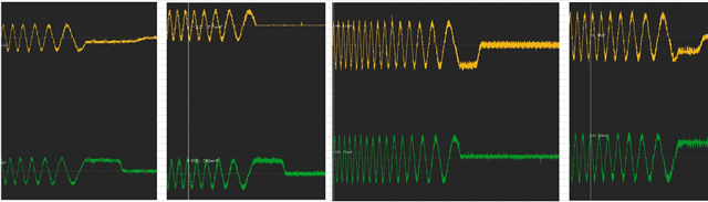

  • Hi Grzegorz,
      Please kindly look at the acceleration/deceleration waves as blow, it looks good.
     I uploaded anothers 2 abnormal phase current wave in the following replies, please help analysis as well. Thanks!
     Jian
  • Hi Jian,
    The last waveforms look OK but drop in current during accelaration means that drive + motor operate in the region of mid-range instability area which may be tricky. I explained that in my first post.
    In case of first waveforms at V5000, not stable current might be a sign of resonance in mid-range instability area. I can not tell why some of DRV8825s may show that symptom and other not.
    To analyze what is going on with 4 waveforms in deceleration phase we would need to know how STEP, VREF and nFAULT signals look like and maybe also other signals like DIR, nRESET, nENBL and nSLEEP.
    Grzegorz
  • Jian,
    According to the current with "missing step", the motor is running in speed mode (not count how many steps). In that speed mode, the back EMF is higher enough to make the output current doesn't follow the sinusoidal waveform. It could also cause the current glitch with motor vibration or load torque spike.
    From the waveform, I cannot tell  the indexer table moving to the next step setting or not with one STEP pulse.
    Can we slow down the motor and monitor the STEP pulse while monitor the output A and B current? BTW, when we say miss step, it means the output current doesn't change with a step pulse. If the current changes, I cannot say the motor driver misses steps.
