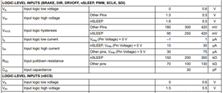

Hello TI experts,
My customer now tests MCT8316Z for their new product, and they have a question.
they want to use 2.5V IO voltage when using SPI interface.
but I found that only 1.8V / 3.3V / 5V in datasheet, page 1.
i am worried about threshold voltage of high and low when I use 2.5V IO voltage.
anyway is it possible to use 2.5V IO voltage?
please check this issue. Thanks.
