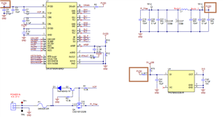

According to the SCH above,LDO  power input is from Node 2,after PI filter.
This design is from DRV8705H-Q1EVM,the link is as below:
 www.ti.com.cn/.../DRV8705H-Q1EVM
Why not LDO power input connected to Node 1?
Is there  EMC test data to support this design?
I think Node 2 is more noisy than Node 1 while the motor is running.
  • Hi Zhengwei,
    The reason is because we need the PVDD supply to come AFTER the Pi filter to filter out any differential noise coming from the main power supply line.
    It seems we don't have this data available at the moment.
    This would be true if the current flows back to the power supply which can happen when the decay mode is set to diode frewheel (COAST) mode.
