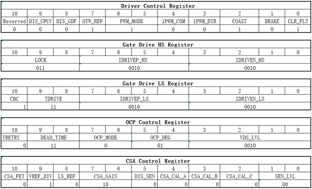

    Can you please let me know what are the device register settings that you set through SPI?

  • Hi Matt,
    The SPI is as follows.
