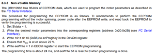

I am facing some kind of problem in writing to the EEPROM of DRV10983. I am using MSP430-G2232. I have followed all the instructions mentioned in the EEPROM Programming Guide For DRV10983. Connected the Speed pin of DRV to GPIO of MSP430G2232 and pulled it low in the program. I am using I2C to send speed command. Even after writing OverRide bit to 1 in SpeedCtrl2 register, the DRV doesn't bring the motor to 0 speed or program the EEPROM.
