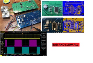

Yes, it is a very strange case, but the repeatability is enormous.
On a new batch of my device, these drivers began to fail. Approximately 50%. I'm in panic.
(old batch consists about 800 drivers and it's working properly)
What it looks like:
At some point during the work (or at once) the stepper motor began to spin slowly (step freq is constant). I had discovered with oscilloscope,that driver began to work in 1\16 microstep mode.  All MODE-GPIOs directly on the ground, that's provide "no microsteps mode". I'm working without microstepping. So I have replaced this driver to another board and found, that driver stucks in 1\16 microstep mode forever, regardless of MODE0-1-2 (I tried to pull-up MODE_0 for 1\2 microstep mode, but nothing has changed).
It's seems like something is failed inside the driver. If I increase the step frequency by 16 times (like goes to 1\16 mode), the driver works properly.
FAULT pin in good state. Soldering is good, I checked it, MODE pins on the ground.
I'm in deadlocked situation.
The old batch and the new batch have the same sch, pcb and code. I suppose it works on the brink of failure=)
I have not found such cases. SCH, PCB and oscilloscope screenshots of a GOOD and BAD driver are attached.
  • Hi Egor,
    Just one hint before I go on my holidays. I would check why there is so large PWM noise present on STEP input on a bad board.
    It is much higher than on a good one and may cause DRV8825 malfuntion. I would also swap DRV8825 between old good board and a new bad one and see if failure follows an IC.
    Thermal relief between DRV8825 thermal pad and ground plane is a bad thing.
    Grzegorz

  • Yes, PWM noise is presented. But I suppose that it's a feedback, cause I have 3 drivers on board and one STEP source (via multiplexer)(one of them is good).
    And a good point about bad GND POLY. Because the previous PCB version didn't have a Poly at the same layer (attached). I should have to repeat it  or fill thermal pad by region. BUT! The board has 4 layers. One of them is GND. Can it be the reason of failure in this case?
    Anyway the bad driver can not be recovered, It's always stayed in 1\16 mode...
  • tWH = 200 uS; tWL = 1400 uS;
    About thermal PAD I wrote in previous reply. Can fix it next time only.
    Anyway it's hard to believe that on a 4-layer board (one of them is GND) this bad poly-thermal-Pad is the reason of failure.

  • I've swapped DRV8825.
    STEP signal is CONSTANT (tWH = 200 uS; tWL = 1400 uS;)(Same code)
    There are two identical step motors.
    On oscilloscope:
    yellow ch. - STEP;
    pink  ch.- B- of GREEN;
    blue ch.- B- of BLUE oard.
    Experiment A: GREEN board(NEW PCB), DRV#1 (dot mark)   VS   BLUE board(OLD PCB), DRV#2(line mark).
    The step motor of GREEN board rotates 16 times slower than еру other. It's like 1\16 mode again.
    THAN I've swapped DRV8825.
    Experiment B: GREEN board(NEW PCB), DRV#2(line mark)   VS   BLUE board(OLD PCB), DRV#1 (dot mark).
    There is the same view at the oscilloscope and the same speed of all step motors.
    I decided repeat experiment with changing microstepping mode and pulled up MODE0 (1\2 mode)
    Experiment C: BLUE board(OLD PCB), DRV#1 (dot mark). (that I take frome GREEN board).
    MODE0 > 3V3, MODE1 > GND, MODE2 > GND,
    And step motor begin rotates slower...
    It looks like the green board make DRV8825 slower for 16 times forever. Is there some CLK module that's can be broken?
  • Hello, Egor,
    Good finding. If put DRV#2(line mark) back to blue board, the motor speed is slow, we can confirm the "MODEx" pin damage.
    On the schematic and layout, I saw MODE0,1,2 were connected to ground. It is hard to believe MODEx pin damage. Actually, green board thermal performance should be better. I would like to make the thermal pad have a solid copper pour connection which can further improving the thermal performance.

  • Egor,
    Yes, the thermal issue is not related to micro-stepping setting. According to the MODEx pin table, the green board made MODE2=1 and MODE1=0. But, the MODE0 pin still work to give 32 microsteps.
    I cannot believe that the green board MODEx pin ground connection can damage the device.
    1. Would you try a new device on a new green board? 2. Would you check the green board MODE2 pin connection?
    Wang Li

  • I've checked 10 boards = 30 drivers.
    12 are bad. Don't work at the first "On". 18 are good. Summary there are about 40% defect.
    There are two data codes: 06TG5 C6C1 and 05TG5 ALV1.
    I'm starting to think about re-routing the PCB and replacing the driver with another, for example DRV8889.
  • Hello, Egor,
    The only thing I can think about is: an ESD event damage the MODE2 and MODE1 pin. Please contact local sales or our quality engineer to do a failure analysis.
    Wang Li
