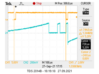

Tests with the new driver shows, that the motor speed is inconsistent, due to a delay in applying the next step.

compared a legacy board with a new one shows that the drivers are working different.
We could measure that the driver applies the next step only when the winding current is decreasing and toff time has expired or the winding current is increasing.
lower the toff time increases the chopper frequency, but the "dead time" still exists. (R= 12 kΩ / C = 1 nF --> 12us)
extending the toff time decreases the chopper frequency, "dead time" stands, (R= 100 kΩ / C = 1 nF --> 100 us)
Varying the voltage on the DECAY pin, does not have any effect!?!

    Observed Problem:
    Lets focus on this:
    Driver Output has sometimes a delay on step execution.
    On rising edge on the STEP input the driver should execute the step immediate.
    Step_Execution_DRV8818

  • Hi Ryan,
    We are not able to modify the firmware, but we have used a pulse generator to drive the steps with approx. 50% duty.
    Steps generated from MCU:
    • f = 1.34 kHz
    • Ton = 720 us
    • Toff = 24 us
    Steps generated with Waveform Generator approx. 50% duty:
    • f = 1.34 kHz
    • Ton = 400 us
    • Toff = 346 us
     The behavior still exists.
    Fabio
  • Fabio,
    Thank you for the test result. I think you have found the root cause which was related to the PWM clock. It is reasonable. When STEP rising edge is accept by the DRV8818. DRV8818 Itrip comparator could change the current setting. But, the Itrip comparator would check the current setting in the beginning of the next PWM cycle. So, the output takes action at that time.
    Also, I think the workaround solution also looks good to me.
