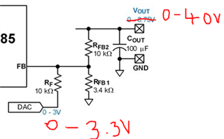

    My load is a piezo blower.
    The vendor of the blower uses an H bridge.
    The supply of the H Bridge is from a boost converter. The boost converter voltage can be adjusted using an MCU like the below circuit.
    So, if I am using this DRV8812PWPR as the driver, is there any problem to change the voltage at the VM pin to adjust the power of the blower just like the above setup?.
  • Shibin,
    In this case, the motor driver device doesn't need to do the voltage regulation. Changing VM voltage is OK to me.

  • Shibin,
    I don't see any problem if the VM is in the recommended range. Since the motor driver circuit is included in boost converter feedback loop, I would think you may need to use EVMs to test system before finalizing the solution.
