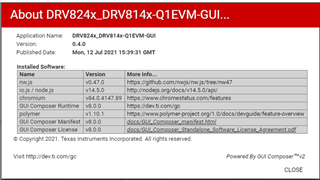

  • Hi Team,
    Please find feedback below, can you please advise further here?
    Attached I am sending you some pictures. As they say, I gave 12v from vBat, I also flash it via GUI. 13 and 14. Com port on my PC, I tried every baudrate on both ports, but it still says there is no connection.

  • Hi Furkan, Thanks for the update. "Flash Successful" message using GUI 0.4.0 is good news. As well as COM ports enumeration looks correct. The correct COM port is "MSP Application UART1". Typically manual selection will not be necessary. COM port and baud rate 9600 will be selected automatically - not necessary to try other baud rates only 9600 will work. Could we also please verify the jumpers, specifically J1 and J7 in suggested positions per the EVM UG and also please make sure the Status LED is blinking approximately once a second before the GUI selection for DRV824xS-Q1EVM is made. If it is not blinking, pressing push button S1 will reset the on board MCU and start blinking the Status LED. Thanks to the customer for their kind cooperation and patience and thank you. I hope we can get to a resolution soon.
