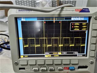

    The customer sets the en and nsleep pins of the motor high, the motor starts vibrating and then enters a step signal to the motor, still vibrates. Since the customer does not have a current monitoring device, a 3-ohm observation voltage is placed between the stepper motor and the drive board aout1 pin, as shown in Figure 1. In the same way, it is observed that bout1 has no output and no change after the stepping signal is given, as shown in Figure 2.
    For vref, the customer inputs a voltage of around 2.9v via the dac of the control board (since the drive current is 1A), but the motor will still vibrate even if the vref pin is left empty when enabled.
    Figure 1: Aout1 output
    Figure 2: Step signal

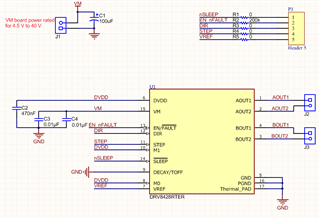

    Figure 3: Schematic (Drive chip is co-located with control board via power)

  • Cherry,
    Why is the low voltage of the stepping signal not at ground? Is the controller floating from the motor driver ground?
    BTW, on the layout, please make solid connection on VM capacitor and DVDD capacitor, instead of hatched connection.
