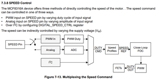

    3.) Could you help me to check if SPEED( to DDP442X CW_PWM) / nFlAULT (to DDP442X  PMD_INTZ) connect correct?
    Motor speed can be controlled via PWM, Analog or I2C mode. Looks like the customer has a 10k resistor connected to SPEED pin. If they wish to control the motor speed via analog mode, a 25kΩ 0.5W potentiometer pulled to 5V can be connected to speed pin to vary the motor speed.
    Check section 7.3.8 (SPEED Control) in the datasheet for more details.
    I do not see how to connect the speed pin in the datasheet, could you tell me how to know customer need to add a 25kΩ 0.5W potentiometer pulled to 5V

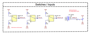

    Please refer to the attached MCF8316AEVM schematic (page-2).
    MD038A1(001)_Sch.PDF
    Vishnu
  • Hi Vishnu
    Thanks for your comments,
    I still not see the 25k in the circuit.
    I only see this figure on the page 2
    Jason
  • Jason,
    R4 is the potentiometer. Part number is 3352T-1-253LF.
    Vishnu
  • Hi Vishnu,
    I got it, thanks.
    Jason
