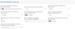

  • So now I can talk the the board and it spins (open loop).  I'm only trying 25-30% Speed Command Percentage
    But now I'm getting one of three behaviors:
    • Motor starts, runs open loop, stops, tries to start again, fails, no fault, "Algorithm State" = "Close Loop Aligned"
    • Motor starts, runs open loop, stops, faults with "LOCK_LIMIT" fault. , "Algorithm State" = "Close Loop Aligned"
    • Motor starts, runs open loop, stops, starts again, but seems to stutter periodically, faults with "LOCK_LIMIT" fault. , "Algorithm State" = "Close Loop Aligned"
    • Motor starts, runs open loop, stops, starts again, but seems to stutter periodically, faults with "HW_LOCK_LIMIT" fault. , "Algorithm State" = "Close Loop Aligned"
    Once I get to the close loop aligned status, I have to do a POR to get the motor to spin again.  Clearing the fault does not allow the motor to spin up again.
    I have ILIMIT, LOCK_LIMIT, and HW_LOCK_LIMIT set to 2.5A (have tried 3.0A, but my PSU is only rated for 3A).  However on my PSU, most of the time it draws less than an amp (1-200mA), but at least once during the transition to closed loop did I see it spike to 2.5A (which is what I have my PSU current limited to).
    This was with first set of registers in the attached file.

    Again, with this motor hooked up to my ST motor controller, I have none of these problems and can spin the motor reliably.
  • Gregory,
    1. I see that you have programmed below motor parameters in the GUI. Are these from the datasheet or MPET measured values?
    2. Looks like device is failing to enter closed loop. Can you disable "auto handoff" and set the handoff frequency to 20% (see screenshot below)
    Vishnu
  • 1.  Must be from MPET as I did not manually enter them.
    2. This screenshot is before I changed OPEN_CL_HANDOFF_THR to 20%
    So, I made the changes you suggested, and I thought that fixed it - but in the end, it just delayed the problem.
    The motor seemed to do it's initial ramp up just fine, then it slowed to nearly a stop and started again, was running nice and quiet, but then choked again.  This time, the MSP430 freaked out and lost communications, and I had to do a POR on everything.  Tried to reload the registers and restart the motor, now it's stuck in MPET KE_MEASURE and won't start.  I'm sure after a few more POR cycles I can cajole it back into working again, but I still don't know what's going haywire.
    There was a section on debugging motor overcurrent issues which showed a graph where the current spikes for some odd reason.  I wonder if that's not what I'm fighting.
    Also, how do I force the algorithm state back to MOTOR_IDLE without PORing?
  • Gregory,
    What is the number of pole pairs in your motor? Is there any reason for choosing FOC over TRAP? Your motor's inductance is pretty low (38 uH) which is pretty low for FOC. Can you try MCT8316A?
    Vishnu
  • I have that board, it does work, but FOC is quieter.  I have another vendor's FOC board, and it works mostly fine, but the simplicity of the TI solution is appealing.  Why the TI solution cannot replicate the results I'm getting with the other FOC controller is puzzling.
    What I'm looking for is a way to diagnose what is not working.   I did use the recording function of the GUI, but I think it's too slow to be of much use.
  • Gregory,
    As the inductance of this motor is too low, I would recommend increasing the PWM output frequency all the way up to 75 kHz. I see that right now you are at 30 kHz.
    Vishnu
