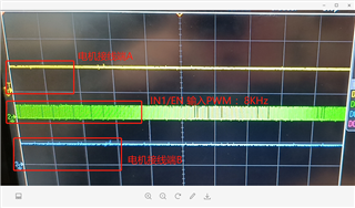

The values of the drv8705 register 0x00, 0x01, 0x02 read back through the oscilloscope are as follows: (No error shows from the oscilloscope)
IN1/EN, motor terminal A,B, as follows:
(From top to bottom, the Chinese in the figure means: 1. Motor terminal A. 2. IN1/EN input PWM: 8KHz. 3.Motor terminal B.)

    Customer's issue is gate drive does not toggle while IN1/EN input. And no fault was confirmed by reading 0x00, 0x01, 0x02 if I understand correctly.
    Here is a couple of though.
    -DRVOFF pin is high
    -nSLEEP pin is Low
    -EN_DRV bit is 0
    -Better to confirm BRG_MODE configuration.
    -Better to check DVDD and PVDD supply voltage and external circuit/FET connection. Customer can refer TI evaluation board schematic as reference.
    https://www.ti.com/tool/DRV8705S-Q1EVM
    regards
    Shinya Morita
  • Hi Shinya,
    Thanks for your support.
    -DRVOFF pin is high
    Yes, they have checked.
    -nSLEEP pin is Low
    nSLEEP pin is high.
    The EN_DRV bit of the IC_CTRL Register is 1, enable; the BRG_MODE bit of the BRG_CTRL Register is 0x01, select PH/EN H-bridge control.
    The relevant bit of the above register, confirmed by readback, EN_DRV bit is 1, BRG_MODE bit is 0x01, pin is confirmed using an oscilloscope. DRVOFF is high and nSLEEP is high.
    The customer would like to figure out why does the pin and register above drive the motor properly when they are set to such condition or value. Could you help elaborate it?
    Thanks and regards,
    Cherry
