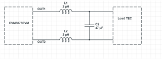

I just receive on of DRV8876EVM and it work fine but I have problem when I connect LC circuit to it the fault light turns on.
scope: we are trying to run TEC with this h bridge, but in order to smoot pwm we using inductor and capacitor as LC circuit.
Base on my simulation, I should be able to smooth the 100khz pwm to sign way signal.
The cut of frequency I pick was around 707hz and inductor of 2uh and capacitor of 47uF
Please let me know if you need any other information.

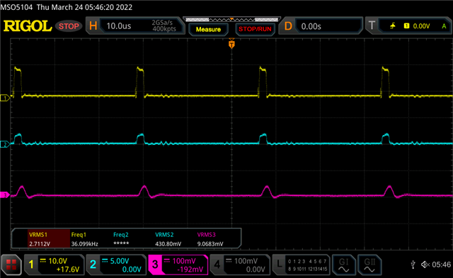

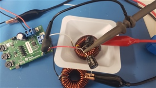

  • Hi Grzegorz,
    I have tested based on requirement and it works. Never thought I need that big of inductor to run this TEC. I really appreciated your help, just when ever you had time I will be appreciated if you can explain to me how to did come with these inductors and capacitor.
    Below is the result.
    No Load one side:
    The other side
    Below picture are with current probe with 100mA per 1 mV
    Lower PWM

    Could you share a circuit diagram of connections between board, LC filter components and TEC?
    Grzegorz

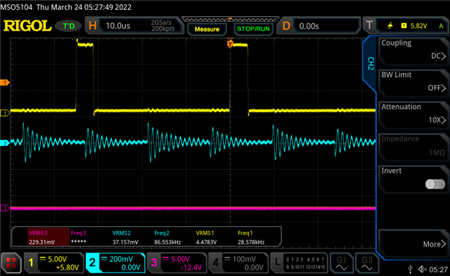

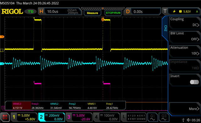

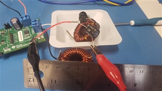

  • Hi Grzegorz,
    Below is diagram how I connect everything DRV8876EVM. Also recapture the voltage again without any load.
    Please let me know if you need any thing else.
    Inductor ATCA-08-251M-H (250uH 27mohm)
    Capacitor ECA-1HEN470 (47uF 20% 50V )
    Setup
    Voltage Probe (Between GND and Each output)
    No Load No LC (DRV8876EVM output)
    With LC filter no Load
  • Hi Amir,
    On the second and last waveforms there are some oscillations caused probably by switching operation and long wires, their amplitude is not very large and I guess they should not cause any problems. The third one shows quite well filtered DC voltage.
    You can get more precise measurements by connecting oscilloscope probe grounding cable to metal bar in the right bottom corner of DRV8876EVM board. The shorter grounding cable the better.
    Please connect the GND point of both capacitors directly to that bar or with a short wire (no longer than lets say 3-5 cm)
    I am only worrying about possible LC filter resonance. Could you make the following measurements when TEC current is a sinusoid at around 1kHz (like on previous waveforms):

  • Hi Grzegorz,
    I update the setup base on your guide line, below is the graph for each just didn't know what do you mean by VM.
    Two alligators go to oscilloscope.  every cable is around 5cm, I couldn't go smaller since the inductors are so big and do not want short anything.
    Please let me know if you need any other measurement.
    With Load:
    1us per div
    Other side
    To ground of capacitor (Do you still want this with 5V/div)
    Current probe

  • Hi Amir,
    Sinusoidal TEC currrent and caps voltages look like LC filter resonance. We will try to find its source and limit its amplitude. The third waveform from the top (from your last post) shows voltage of around 6.4V rms what gives capacitor ripple current of around 1-1.8A, that is much higher than its rated ripple current. Please, monitor temperature of capacitors, they may get hot and even explode. If they are getting hot, please try to add more of these caps in parellel, that may help to limit possible resonance.
    Grzegorz

  • Hi Amir,
    Lets start with last waveforms.
    1/ VM looks OK, its max. value is around 12.5V and min. value is around 12V
    2/ Voltage on OUT1 looks strange probably because of high voltage drop caused by Rdson and OUT1 current which depends on LC filter and TEC. Minimum OUT1 voltage is around 9.5V what gives 2.5V peak voltage drop, it is a lot.
    3/ Voltage on OUT2 is caused by voltage drop on LS Mosfet Rdson, its max. value is around 2V, again it is a lot.
    4/ Voltage on capacitor ground, it is some noise picked up by red ground wire and grounding cable of oscilloscope probe
    5 and 7/ OUT1A voltage, its max. value is 15V (more than VM max at 12.5V ) and has very nice sinusoidal shape, it suggests that LC filter is in resonance, not a big one but resonance. I think it is caused by OUT1 PWM frequency (1kHz) which is close to LC filter resonance frequency.
    Vref= 2.75V what gives current limit of around 1.8A, I estimated earlier that Rms current of capacitor is around 1-1.8A (1.4 - 2.5A peak) and TEC current is around 0.7A peak (it would be geometrical sum, so we can not just simply add these values), all that suggest that DRV8876 is working in current limit mode and it is causing that LC filter resonance. Additionally EN/IN1 is 3.295V, so probably PWM duty cycle is 100% and we can not see PWM of 30kHz at OUT1 and so on.
    8/ Current of TEC is sinusoidal and quite symmetrical with average value around 0V, what probably brings very low TEC efficiency.
    If you place current probe between OUT1 and inductor you may see a waveform similar to one on Figure 12 in datasheet below
    www.ti.com/.../drv8876.pdf
    I think you need to try to go out of LC filter resonance and possible current limit mode by:
    a/ Adjusting EN/IN1 potentiometer to lower EN/IN1 voltage so PWM of 30kHz will appear on OUT1 - the safest option
    b/ As above plus trying to lower/increase capacitance of capacitors what may bring possibility to work with a bit higher EN/IN1 voltage and PWM duty cycle (and TEC current)
    c/ As in point "a" plus increasing current limit with Vref potentiometer - possibility of DRV8876 overheating.
    Grzegorz

  • Hi Ryan,
    I received my ceramic capacitor, as before  the the current very low, also LC filter did not filter the PWM as you can see on second result.
    1. No Load   Ch1: output2  Ch2: output1 Ch3: Vin
    2. No Load with LC filter:  Ch1: output2  Ch2: output1 Ch3: Vin
    2. No Load with LC filter:  Ch1: LC2   Ch2: LC1 Ch3: LC GND
    2. With Load with LC filter:  Ch1: LC2 Ch2: LC1 Ch3: Current Probe (1mV/ 100mA)
    Please let me know if you need more data.
    I purchase 22,10, and 4.7uF ceramic capacitor too.
  • Amir,
    Sorry, I am little confused at where the measurements are being taken.  Can you please mark on diagram below?
    Ryan
    See if this help
    3. No Load with LC filter:  Ch1: LC2   Ch2: LC1 Ch3: LC GND
    4. With Load with LC filter:  Ch1: LC2 Ch2: LC1 Ch3: Current Probe (1mV/ 100mA)
    Please let me know if you need more information.
