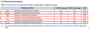

Background: when the IC is operating normally, the Tc is experimentally measured and the power loss (Power) is known to calculate the junction temperature.
The customer would like to confirm which of the following (R θ JC(top) /R θ JC(bot)/θ JT) thermal resistance is used to calculate Tj more accurately:
  1. Tj=Tc+ RθJC(top)*Power
  2. Tj=Tc+ RθJC(bot)*Power
  3. Tj=Tc+ ΨJT *Power
Could you help resolve this case? Thanks.
