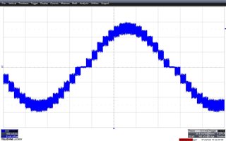

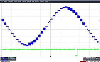

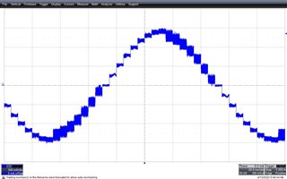

I am testing the TI DRV8818PWP as a replacement for an Allegro A5977.  An observation has been made that the first step after crossing zero A has a current oscillation that it not present with the Allego part.
Allegro:
TI

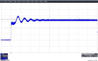

Zoom into looking at the first step:
