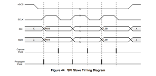

Can you please confirm which all among the standard SPI modes( i.e. among SPI mode 0,1,2,3) is supported by DRV8343. And is it possible to change via register settings

Hi Stephen,
DRV8343-Q1 supports SPI mode 1 only.
