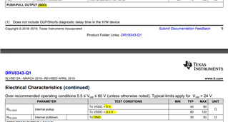

We would like to know the output logic low voltage (VOL) and output logic high voltage (VOH) for the SDO (SPI Output data) pin of DRV8343. It is not mentioned in the datasheet.

Hi Sreelekshmi,
Since SDO is an output pin being driven by the DRV device itself, I believe that the H and L toggling of this signal will be as described below.
The push-pull configuration of this pin will mean DRV driven logic-low will target 0V and DRV driven logic-high will target the voltage set on the VSDO pin (either 5V or 3.3V)
Andrew
Hi Andrew,
Thank you for the response. So, can we take VOHmax = 3.3V and VOLmin = 0V?
Sreelekshmi.
Hi Sreelekshmi,
For expectation of what the DRV device will output - answer should be Yes for the values above.

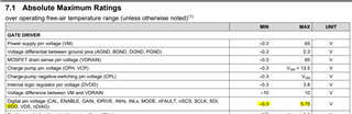

For evaluation of what voltages the SDO pin can withstand & be biased externally, refer to 'absolute max ratings' datasheet section
