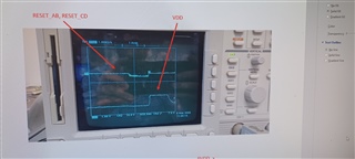

In our design the RESET_AB and RESET_CD and connected together and pulled low via a 1K resistor to GND and driven by the CPU.  In the case where the motor shaft is spun with no control power, the CPU does not have time to power up and boot before the PVDD_x rail discharges, so the CPU does not drive the RESET_AB, RESET_CD net during this time.
What I see is the RESET_AB and RESET_CD voltage will immediately drop to -0.35V respect to GND and remain there until the VDD power rail is energized.  At that time the voltage at RESET_AB and RESET_CD returns to 0.0V.  There is 0.0V deviation between GND_x, AGND, and GND of the CPU the entire time.  Identifying the cause that the internal logic of the DRV8432 must be driving below ground and seen as a negative voltage on RESET_AB, RESET_CD until the VDD power rail is energized.

    Will take this step by step and start with the abs. max. question.  This is an error in the datasheet.  Like you noted, during reversing (or fast decay), current will flow thru that lower diode and output will be below GND.  This is not the cause of the damage you are seeing.
    Regarding the RESETx signals, this is an interesting observation.  VDD supplies the voltage for the internal logic and yes, this is typically regulated off the main supply.  In fact, our EVM is the same way.  So, like your case, VDD on our EVM comes up after PVDD.  I have not seen this negative voltage before and not sure what the internal path is that would cause this, but also don't think that is the issue.
    What voltage is the PVDD supply rising to as it is being "pumped" up by the external motor operation?  Controlling this below PVDD recommended max. with clamping diodes or larger bulk capacitance, to absorb the energy, should be the solution to this problem as it is quite common.

    We are only seeing the voltage feedback of the motor pumping the DC bus up to 25V when turned by hand as fast as we can.  This we have disregarded as the root cause, as the voltage is not higher than the normal operating range of our final product.  We have 2000uF bulk capacitance in the final design.  If we cannot identify a cause then I must place this on a batch of components that were damaged in other means, such as handling.  We have shipped over 1000 units and have only seen this on a hand full of devices on the last shipment.  But concerning that our customer noticed this in their production when moving the motor shaft to align mechanically.
