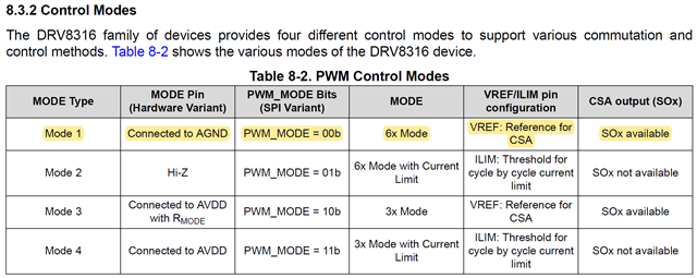

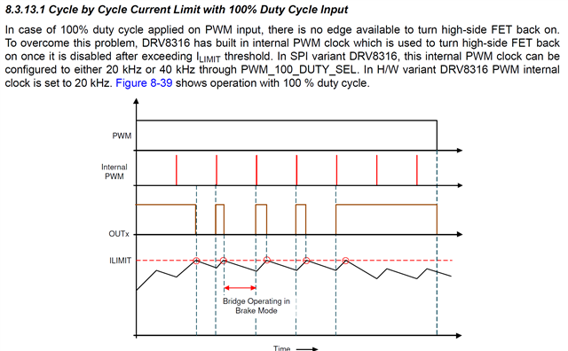

Hi support  team.
My customer has asked me regarding cycle by cycle current limited by internal PWM.
They are considering to use in 6xPWM MODE.
When we use on PWM MODE bit =00b and with 100% duty cycle input, is the current flow controlled by internal PWM clock?
