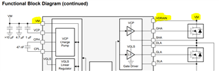

I am looking to use this as a driver for 3x HS and 3x LS independent drivers to drive a total of 6 independent solenoids. The HS drives will be connected to power internally so vdrain makes sense to connected. However, for the Low sides power may be sourced externally meaning vdrive and VM may be zero while the LS drain (the dlx pins) may be non zero (may even be 36v).
Is there a reference design on how to maintain the voltage requirements of the gate drivers, vdrain and Vm pins in this? I have seen putting a diode from the dlx pins to the vdrain pin, but if the external source power is higher than VM that may cause issues with the over current protection for the high side gets or the requirements between Vm and vdrain.

      1. I suggest for us to use the 'Functional Block Diagram' from section 8.2 on page18 as your baseline drawing, and mark-up as needed
      2. the main part that I am unclear on is "However, for the Low sides power may be sourced externally meaning vdrive and VM may be zero while the LS drain (the dlx pins) may be non zero (may even be 36v)"
        1. is there a particular application requirement why VM pin can't just be tied to the same voltage as the VDRAIN pin and MOSFET power stage VDRAIN? Our device typically expects VM to be powered in order for the DRV device to function

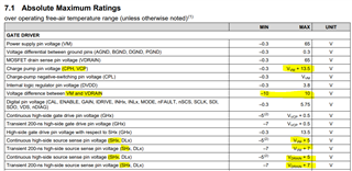

  • Referencing the figure, My controller has a battery disconnect turned on by ignition Pin so the battery can be on, while the controller internal power is off. if the low side switch Load is connected to external power (standard for a low side drive in some applications), then VM/Vdrain would be 0V while the DLx pin is high (maybe 36v), however the datasheet states the DLx pins can only be 5v above vdrain. is there a way to protect against this case? also there are requirements for any pin to be able to handle 36v or gnd while the battery is connected or disconnected which causes the same issue (without a battery disconnect circuit)

    we are still working on the solution for the 6 independent drives, but if we just look at the 3 drives in series, perhaps the diodes below save us? there is a diode in the mosfet SHx to Vdrain and the and the flyback diode from DLx to SHx. does this save us from the SHx/DLx to Vdrain requirements or am i missing something?

    So let's first consider our main abs max ratings that apply in this system-level evaluation:
    • DRV IC pins to be aware of are SHx, Vdrain, VM, and VCP/CPH
    Next, let's identify scenarios that we want to avoid, and why:
    1. VM must be powered on at all times where Vbattery is connected to the load and has a path to the device's SHx pin
      1. this is because if VM is unpowered, then charge pump VCP=0V (references to VM)
      2. the resulting consequence is that SHx voltage (e.g. 24V) will have high Voltage diff w.r.t VCP and will flow through HS pre-driver internal FETs, and then also damage a diode that exists between VM and VCP.
      3. this is why there's a spec max between SHx and VM, and a spec max between VCP and VM
    2. Ideally during device operation (driver switching GHx/GLx=H/L to drive the ext FETs), we want VM and VDRAIN to be roughly the same voltage
      1. this is because VM is used to generate VCP voltage to power the HS pre-driver.
        1. Once again, this VCP references VM and usually the relationship is VCP= VM+11V
      2. the HS predriver, however, generates VGS voltage by pulling GHx up to VCP so that it is ~12V higher than SHx
        1. and SHx is usually expected to be between 0V and VBAT (a.k.a MOSFET Vdrain, not Vdrain pin)
      3. Therefore, if your VM is much higher than your MOSFET Vdrain or vice versa, then the HS gate-source differential could be too high and cause damage to the internal HS clamping diode or external HS MOSFET of a half-bridge
      4. your system may still be safe as long as you don't try to toggle INHx=H under these circumstances, so that HS pre-driver doesn't
    3. So what exactly is the function of the VDRAIN pin of the IC?
      1. VDRAIN pin is a sense input to HS VDS comparator, and it also powers the HS VDS comparator.
      2. therefore, if your VDRAIN pin is disconnected, then you could experience issues such as unreliable HS VDS monitor behavior
      3. also, you wouldn't want to have SHx=24V while VDRAIN pin is tied directly to ground, since I'm not sure if it's intended to experience that voltage and polarity. However, as your VDRAIN pin is floating (not tied to GND), I think we may be okay here.
      4. so the voltage applied to this pin is less about biasing the device in a way that causes risk of overstress, but more-so about voltage bias needed to ensure HS VDS monitor proper functionality
    In conclusion, you might not need a clamping diode after all.
    • I think if your system keeps VM pin powered on to same level as your VBATTERY (MOSFET power stage VDRAIN)] voltage, then the system should be okay.
    • disconnecting VDRAIN pin is not ideal due to impact to HS VDS monitor, but it may be okay if you just leave it floating.
    • maybe you can leave a diode between the MOSFET VDRAIN and the DRV IC's VM pin? That way, you ensure that the DRV IC's VM pin is properly powered so long as the Battery is connected to the load
