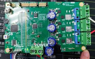

I connected the 3 phases motor connectors and all 3 hall sensors, but the GUI still can not enter Sensored page.
How can I enter the sensored page?

Have you flashed the Sensored Trapezoidal code onto the onboard MSP430F5529 on the EVM? https://e2e.ti.com/support/motor-drivers-group/motor-drivers/f/motor-drivers-forum/1045673/faq-drv8343s-q1evm-how-to-flash-firmware-onto-the-drv8343x-q1evm
