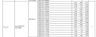

The overcurrent is detected by the OCP function of the driver IC, but when the power supply of the driver IC drops (voltage enough to generate ULVO), does the overcurrent threshold of internal OCP drop ?
OCP has both VDS_OCP and SEN_OCP set.
<Background of this question>
OCP occurred when the power supplied to the driver IC was momentarily dropped (about 5.5V to 6.5V) during motor evaluation at the customer's site,with a current value that was not the original set current.
UVLO was sometimes occurring when OCP occurred.
This voltage drop was due to the current limitation of their DC power supply, but they wants to know if the voltage drop makes OCP more likely.
<Conditions at the time of occurrence>
OCP occurs when the brushless motor is rotated and the power supply voltage drops to 5.5V to 6.5V.
Power supply voltage: Set value DC14.5V
When the motor rotates, it drops to about 5.5V to 6.5V when the current flows due to phase changing.
FET on resistance:1mohm
Shunt resistance:1mohm
Current value:Peak 70A
VDS_OCP setting value:0.26V
SEN_OCP setting value:0.25V
Please advise us.

    The internal VDS_OCP threshold should remain in the min/typ/max specs as long as VM > UVLO. This is confirmed by characterization data, regardless the VM value, the VDS_OCP threshold lies within the datasheet specs.
    If the customer wants a confirmation of this, next week I can test on the DRV8343S-Q1EVM if there is any variation to the VDS_OCP threshold at different VM values.

    For VDS_OCP setting value = 0.26V, here is six-sigma threshold variation at different VM values:
    VM = 5.5V:
    0.261V to 0.275V
    VM = 24V:
    0.261V to 0.275V
    VM = 60V:
    0.271V to 0.289V
