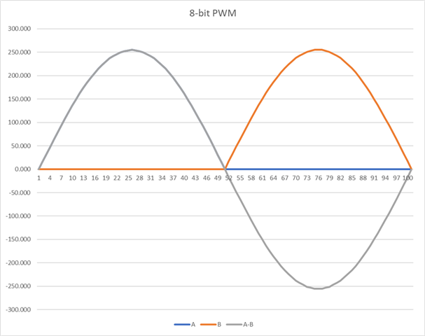

Good day! I am posting this on behalf of the customer. I want to use the DRV8842 to drive a small AC induction motor.
I envision using 2 PWM channels an MSP430, 1 on IN1, and 1 on IN2 to make the alternating current waveform.
I am not sure whether there will be issues with decay in this application.
